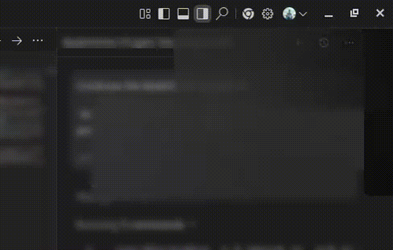

Problem
After updating to KDE Plasma 6.8.0, notification popups appear as blank or dark rectangles. The text becomes visible in the same popup after approximately 35 seconds.
This affects:
  • notify-send notifications
  • Browser notifications
  • System notifications, including Wi-Fi changes
Notification delivery appears to work; the problem seems to involve rendering or updating the popup.

Video showing KDE Plasma notification popups rendering as blank, dark rectangles on EndeavourOS with Plasma 6.8.0, Wayland, and Intel Iris Xe graphics. The notification text is not visible when the popup first appears. The issue affects application and system notifications.
kde_notification_bug
Thanks!
This video, at least for me, doesn’t show anything. Just seems like everything is blurred except some buttons. If you did the blurring, you should try to show the issue you’re experiencing when not using personal or confidential files/apps.

Same here. This is a KDE Plasma related problem. I’m on CachyOS.
Screen record: https://youtu.be/u0A-XQeKHnM
Exact same symptoms after updating to Plasma 6.8:
  • Notification popups appear as empty/blurry dark rectangles in the bottom-right corner
  • After roughly 20 seconds the content suddenly renders correctly in the same popup
  • With the Blur effect disabled, nothing is shown at all
  • With Blur enabled, only the blurred rectangle is visible until the content finally appears
Relevant log while triggering a notification:
plasmashell: No QSGTexture provided from updateSampledImage(). This is wrong.
(repeated several times)
Tested with notify-send (had to raise the timeout so the popup stays long enough to see the content appear). Restarting plasmashell does not fix it. Looks like the notification window itself is not being rendered properly at first — only the blur effect around it.
