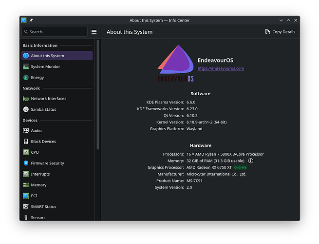

Updated, rebooted! Smooth as silk.

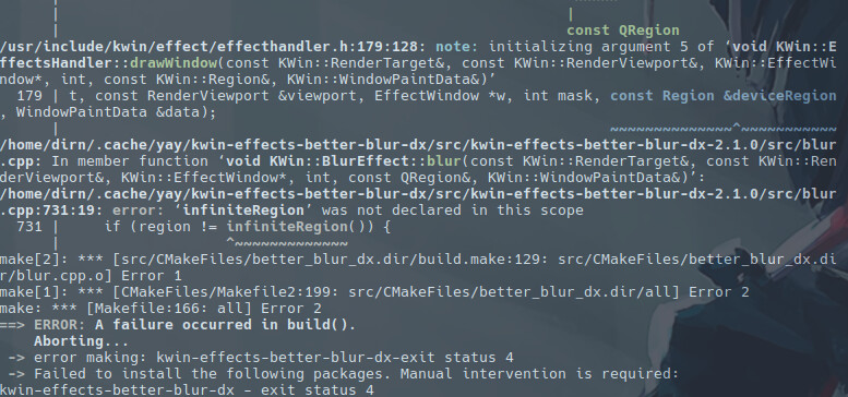

It’s still failing to build betterblur-dx, even after installing the packages you mentioned.
home/dirn/.cache/yay/kwin-effects-better-blur-dx/src/kwin-effects-better-blur-dx-2.1.0/src/blur.cpp: In member function ā€˜void KWin::BlurEffect::drawWindow(const KWin::RenderTarget&, const KWin::RenderViewport&, KWin::EffectWindow*, int, const QRegion&, KWin::WindowPaintData&)’:
/home/dirn/.cache/yay/kwin-effects-better-blur-dx/src/kwin-effects-better-blur-dx-2.1.0/src/blur.cpp:655:58: error: cannot convert ā€˜const QRegion’ to ā€˜const KWin::Region&’
  655 |     effects->drawWindow(renderTarget, viewport, w, mask, region, data);
      |                                                          const QRegion
/usr/include/kwin/effect/effecthandler.h:179:128: note: initializing argument 5 of ā€˜void KWin::EffectsHandler::drawWindow(const KWin::RenderTarget&, const KWin::RenderViewport&, KWin::EffectWindow*, int, const KWin::Region&, KWin::WindowPaintData&)’
  179 | t, const RenderViewport &viewport, EffectWindow *w, int mask, const Region &deviceRegion, WindowPaintData &data);
/home/dirn/.cache/yay/kwin-effects-better-blur-dx/src/kwin-effects-better-blur-dx-2.1.0/src/blur.cpp: In member function ā€˜void KWin::BlurEffect::blur(const KWin::RenderTarget&, const KWin::RenderViewport&, KWin::EffectWindow*, int, const QRegion&, KWin::WindowPaintData&)’:
/home/dirn/.cache/yay/kwin-effects-better-blur-dx/src/kwin-effects-better-blur-dx-2.1.0/src/blur.cpp:731:19: error: ā€˜infiniteRegion’ was not declared in this scope
  731 |     if (region != infiniteRegion()) {
make[2]: *** [src/CMakeFiles/better_blur_dx.dir/build.make:129: src/CMakeFiles/better_blur_dx.dir/blur.cpp.o] Error 1
make[1]: *** [CMakeFiles/Makefile2:199: src/CMakeFiles/better_blur_dx.dir/all] Error 2
make: *** [Makefile:166: all] Error 2
==> ERROR: A failure occurred in build().
    Aborting...
 -> error making: kwin-effects-better-blur-dx-exit status 4
 -> Failed to install the following packages. Manual intervention is required:
kwin-effects-better-blur-dx - exit status 4
