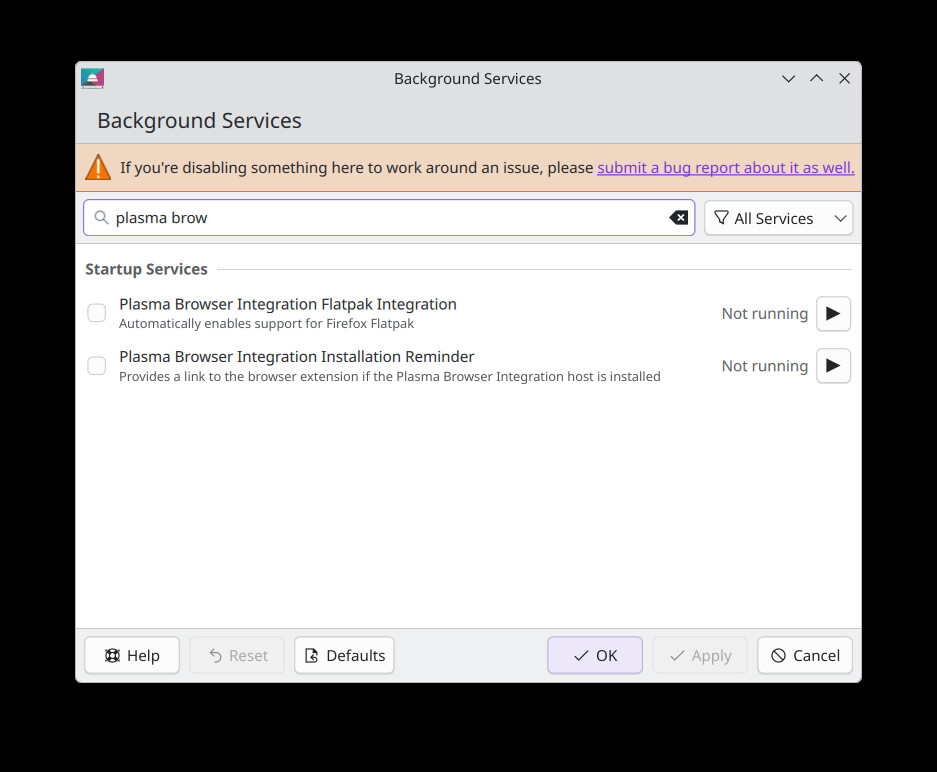

One quick question where do you get the option to disable the service, “Plasma Browser Integration Flatpak Integration”?
I could not find this in the KDE System Settings application.
Why do you think there is such an option?

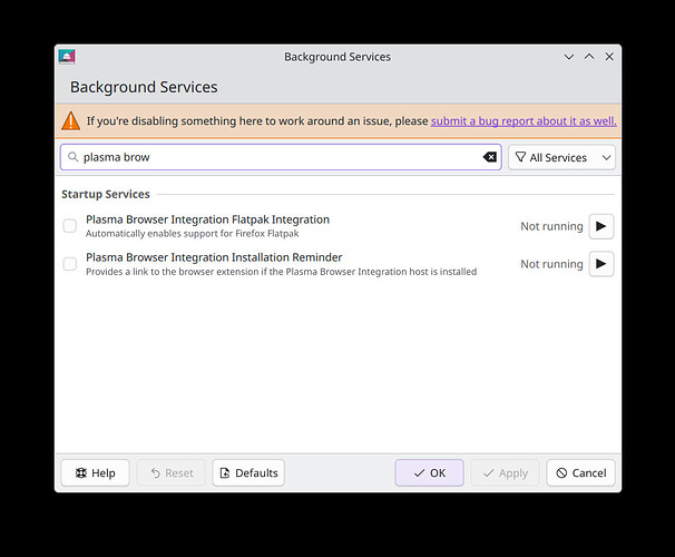

It’s not visible in the System Settings app. You’d need to use krunner to open background services.
Is this the service that you are referring too? This does not appear to be a Systemd unit service.
