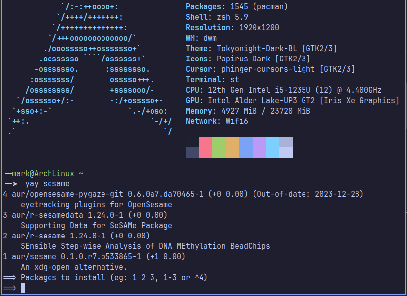

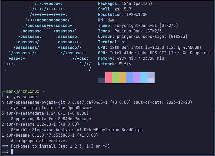

It looks like you can install it using yay. Have you checked?
I did search for it in the AUR. Am I missing something? A yay install would be great.
Here’s what I see. I have no idea if it’s what you want.
