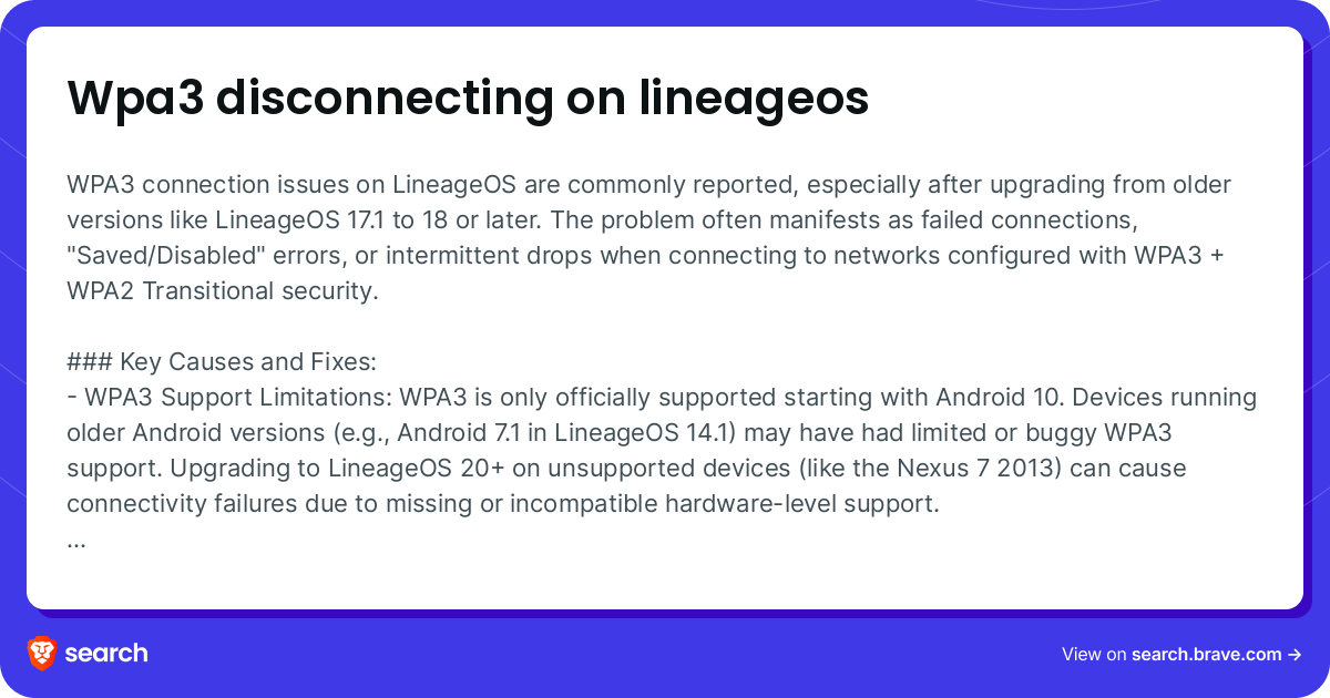

Since you mentioned certain routers (e.g. Home) the WiFi disconnecting randomly, I think we should target those settings.
There are know issues where a router is setup in a WPA2 and WPA3 hybrid mode allowing a device to switch between the two methods. I had to change my Asus router to not use hybrid, but either use WPA 2 or WPA 3 in personal mode.2 of 8 devices at home (Lenovo Yoga and Moto Android 15 phone) had the issue.
More here in AI summary:
Router issues might be possible also. The random mac address issue is also very common with some adapters.
