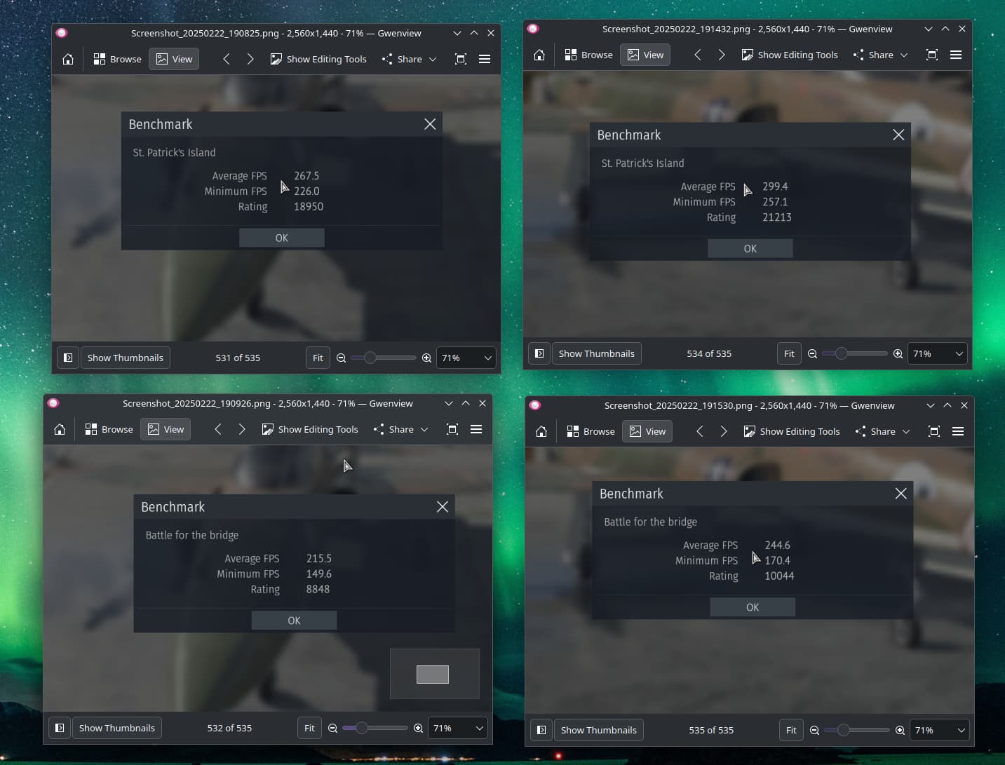

Hi, I am experiencing a performance regression in a lot of games, with this regression being completely reversible by simply downgrading the kernel back to LTS 6.6.
Shown below is a screenshot of War Thunder Benchmarks, with the LTS 6.6 results being shown on the left and the LTS 6.12 results being shown on the right.
I have waited for a long while before updating to LTS 6.12, simply due to this performance regression, in the hopes that the regression would get fixed with time, which it wasn’t. I have no idea what the issue is, any help would be appreciated!

For you device age coul be a factor, but I highly doubt that is the case for me (AMD 7800X3D and an AMD Radeon 7800XT, both just over a year old and bought new). While the AUR solution might help as a short term fix, I still would like to figure out what is wrong with the up to date kernel, as the only difference between benchmarks is the kernel version, with all other packages staying the exact same.
I used War Thunder as an example, as it is a native game so there are no possible issues that could be caused by running through Proton, but a game where the performance regression is absolutely horrid is Cyberpunk 2077, which with the exact same settings, setup and packages (outside of the kernel) suffers an average 15ish FPS loss, on a normal FPS of 60ish. Again, reverting fixes it.

(6.12 on the left, 6.6 on the right)
The regression is even worse on X11.
