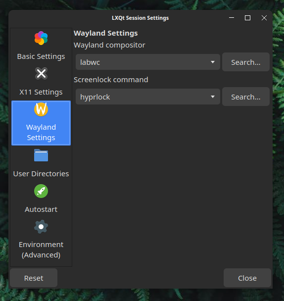

But you use lxqt-wayland-session?
Yes, I use lxqt-wayland-session (with labwc as the compositor).
