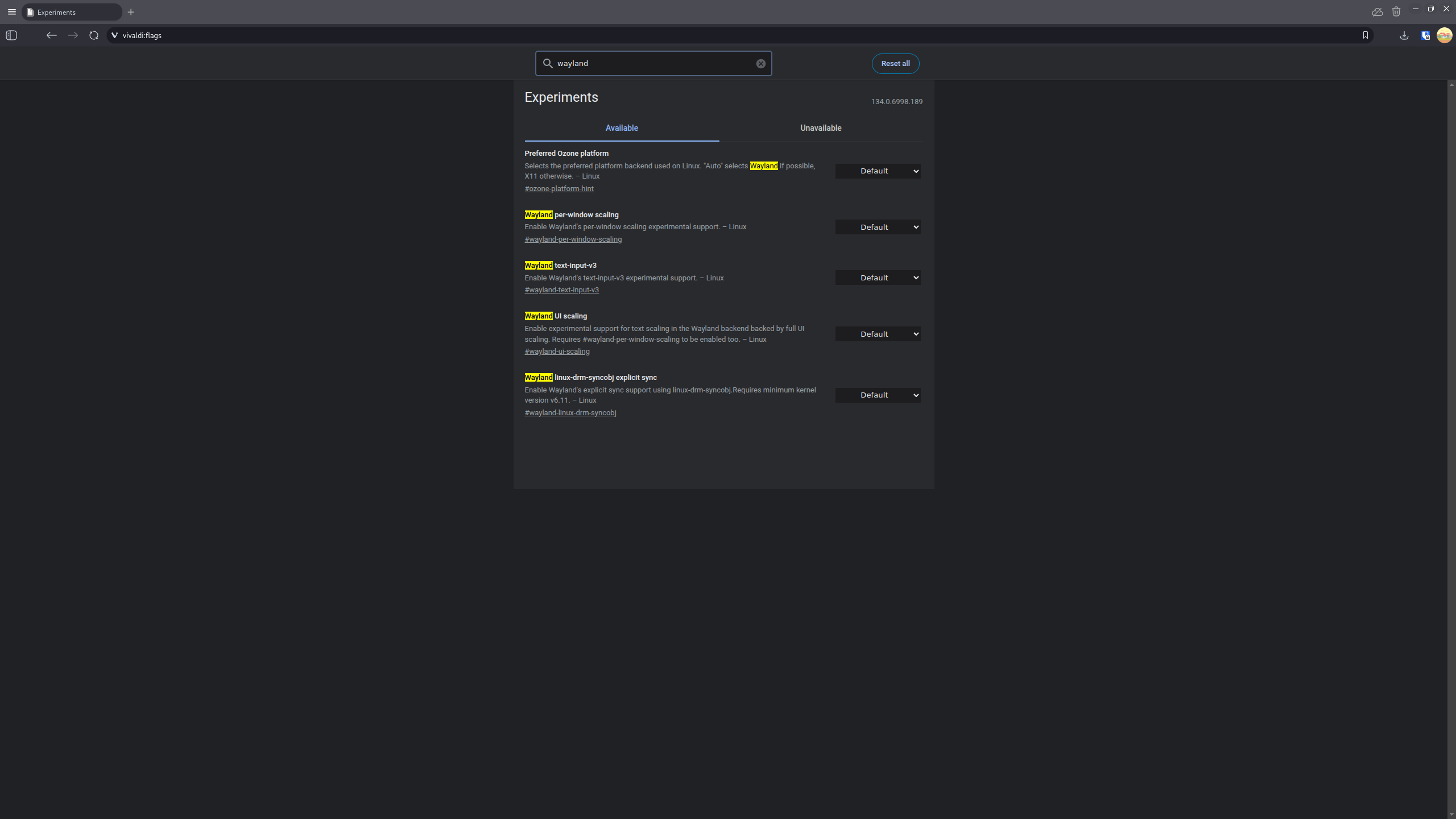

According to what I can find in the settings it will run by default in Wayland if it can because I see this.
Preferred Ozone platform
Selects the preferred platform backend used on Linux. “Auto” selects Wayland if possible, X11 otherwise. – Linux

I looked in the Vivaldi flags/settings.
this is getting better and better, mine says the same but why doest it do what it says???
I went to check and you are correct it seems to launch in Xwayland by default even though it says it will launch in Wayland by default if possible. Only after you set it specically to Wayland it will launch with native Wayland.
