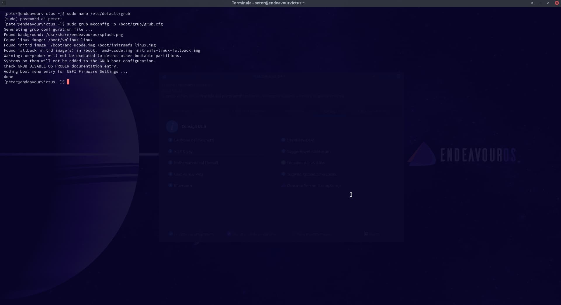

Put it in this line like this as i explained for grub in the post.
GRUB_CMDLINE_LINUX_DEFAULT='amd_pstate=active nowatchdog nvme_load=YES loglevel=3'
Then save as instructed in the post and run the grub update command.
You can use the text editor nano
sudo nano /etc/default/grub
add
amd_pstate=active
ctrl+o then enter to save
ctrl + x to exit nano
Then run the grub update command
reboot
Check with
cat /sys/devices/system/cpu/cpu0/cpufreq/scaling_driver
Thank you so much!
I did it right now. Now the output of cat /sys/devices/system/cpu/cpu0/cpufreq/scaling_driver is:
amd_pstate_epp
It is correct?
This is the output after the grub update command.
Yes that is correct. Now see if it makes any difference.

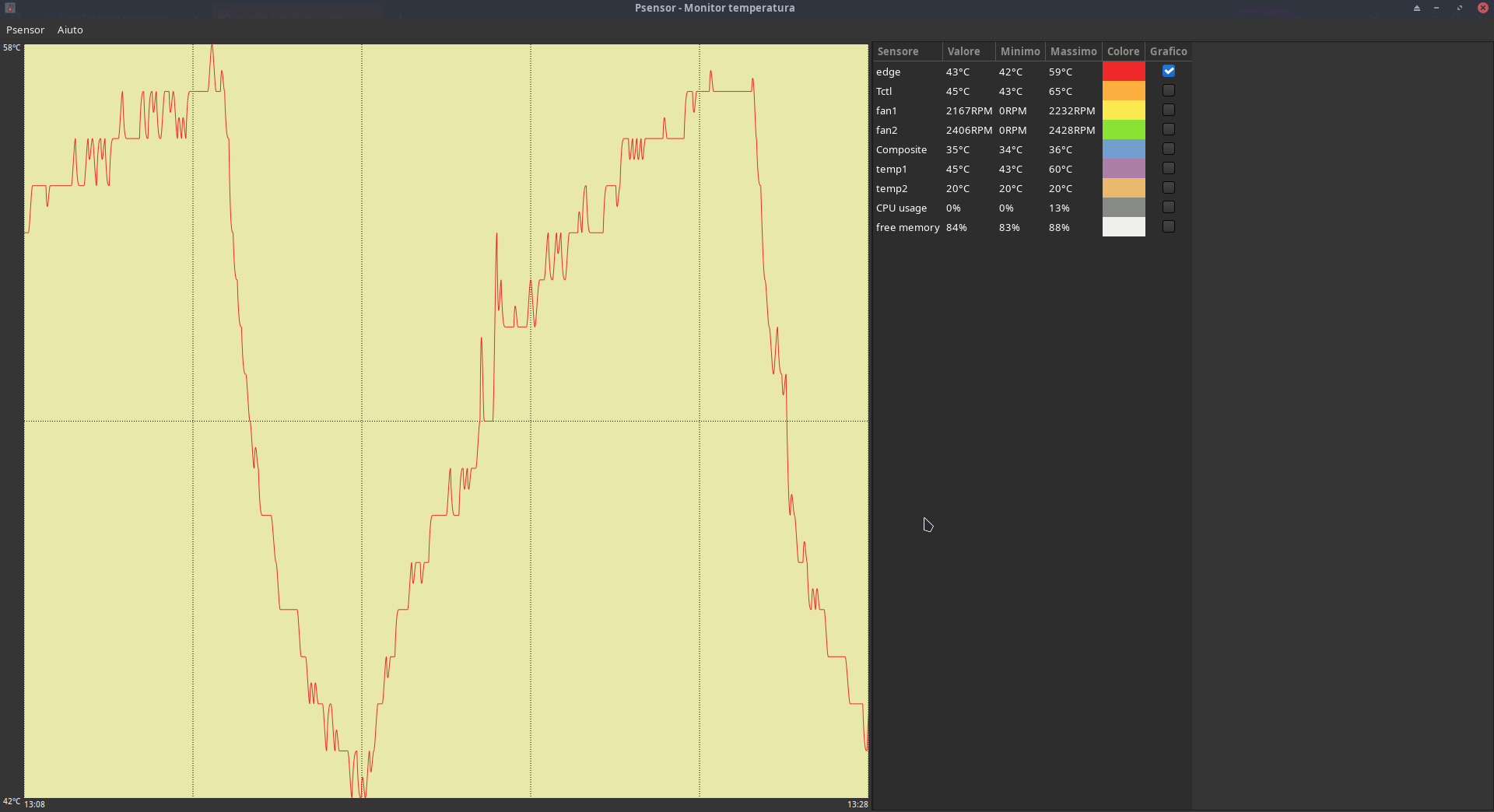

Hi! I noticed that the situation is a little bit better, but comparing the temperatures when I use Windows and also with my old laptop with Arch, I think there is still something wrong.
I installed psensor to monitor the temperature and this is a shot of the situation:
In a normal usage (not playing games or making music) with Windows, and even with my old laptop with Arch, the temperatures almost never reach 50°C. The only difference with my old laptop is that I have the zen kernel on the old one and the default kernel on this new one. Could be this the problem?
Furthermore I noticed that the battery drains much faster then when I’m using Windows, and I think that is strange because instead, with my old laptop, using Linux is more efficient with power consumption than when I used Windows.
Sorry for the many and long messages.

Unfortunately I try to switch from “balance_performance” to “balance_power” but nothing changed. The temperature reaches 60°C in a few minutes, after that, the fans start up until it returns to 43/44°C, but then again in a few minutes it returns to 60°C and so on.
Maybe I should try the “Original Pstate Driver” (https://gitlab.com/echoa/amd-pstate-guide#original-pstate-driver) and the zen kernel instead of “AMD Pstate EPP Driver”? Sorry but now I don’t know why this issue happened and what I have to do to fix it.
Anyway I really appreciate your help, so thank you again.
