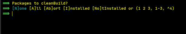

otter-browser is an AUR package, and it was built on your system with libraries from a dependency that has been updated - in this case the repo package icu has been updated, and icu provides libicui18n.so.xx. Your AUR package is looking for the older version that it was built with.
The solution is to perform a cleanbuild of the package. There are several ways to do this; probably the simplest is to simply answer A when yay prompts if you want to cleanbuild the package:
yay -S otter-browser
It will ask “Packages to cleanBuild?” - answer A (for All).
