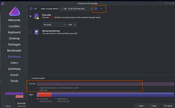

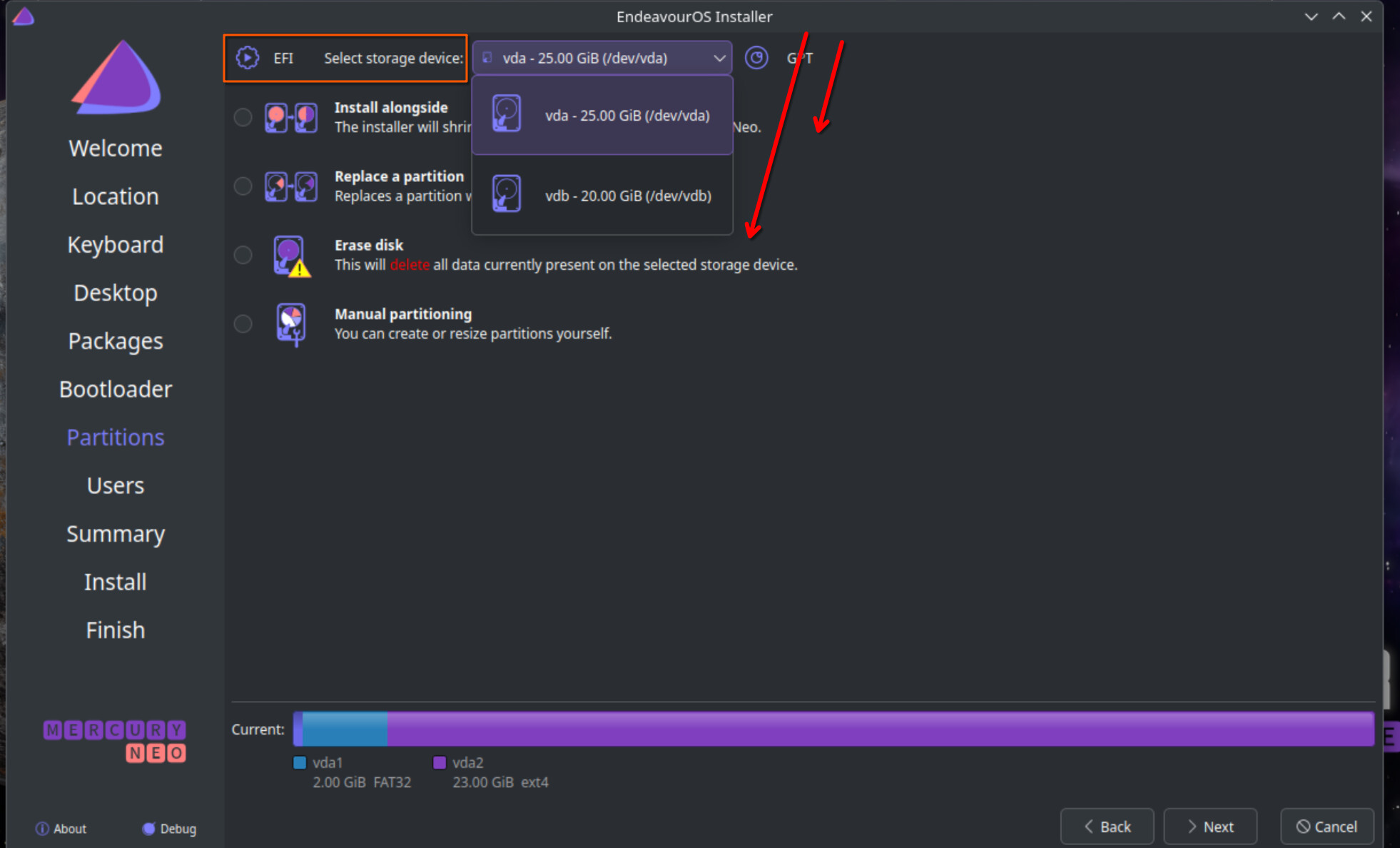

installer would still show the drive .. could be @newuser123 was not understanding the output correctly and it is showing inside installer it is a dropdown list of drives on top of the partition screen ..
yeah could be. I personally would format the ‘unallocated’ so the installer sees a real /dev/sdaX—I really like to baby the installer that is for sure..
i know that option. And when I click it to drop down, it only has the bootable usb as an option.

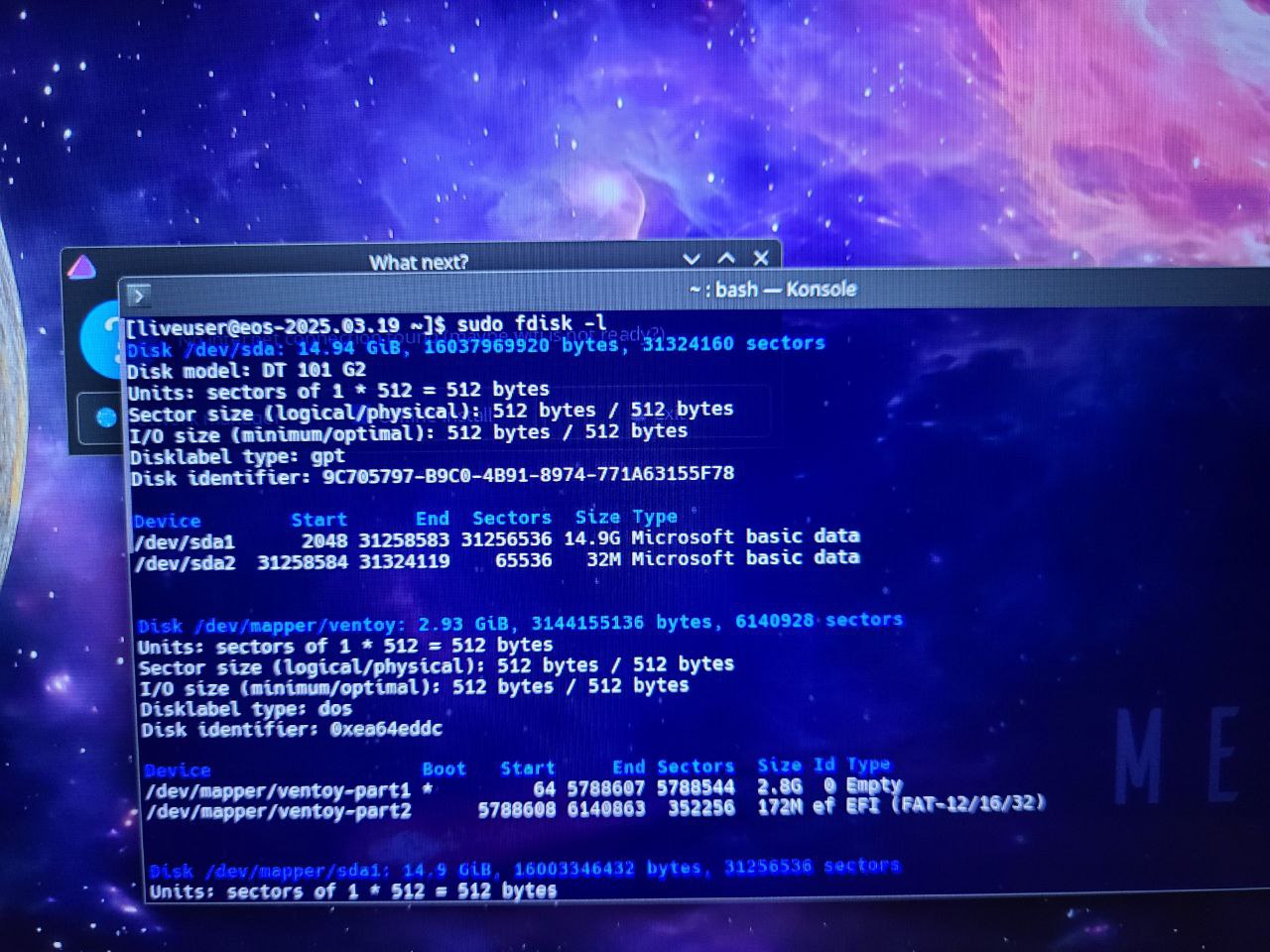

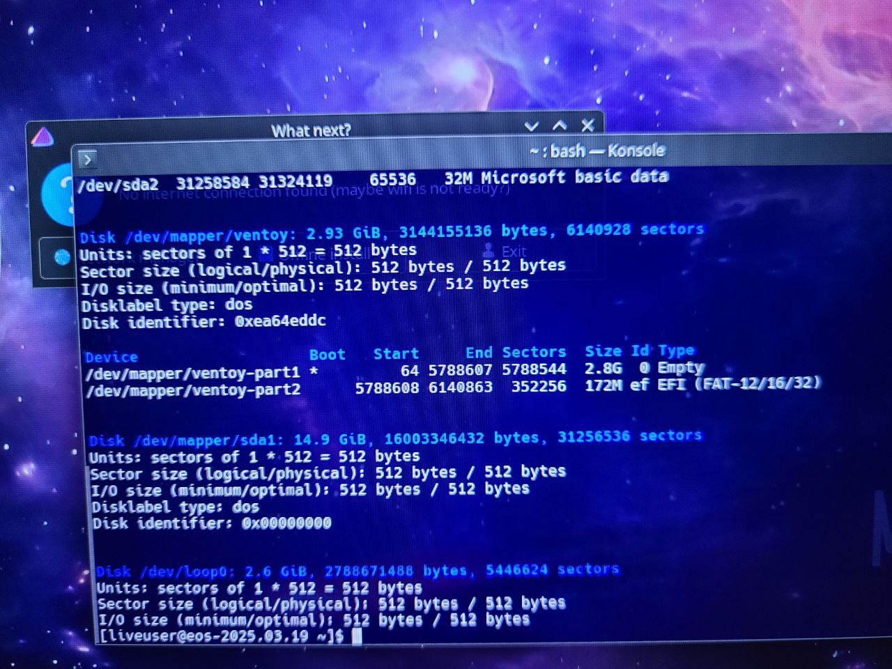

So are the disk(s)/partition(s) still not detectable from the live ISO?
sudo fdisk -l
it was when it happened to me XD I’ve always been quite the multitasker, so when I let myself loose and open several programs, boom, frozen. Several browser tabs open > oh, let me just check this > frozen… I was told those years ago that linux had a way with process handling that made it susceptible to that kind of freezing…
I don’t remember the details, not that it matters. That was on Mint and Endeavour is all the way above it as per every youtube distro ranker, thus my choice for my linux journey 2.0 haha

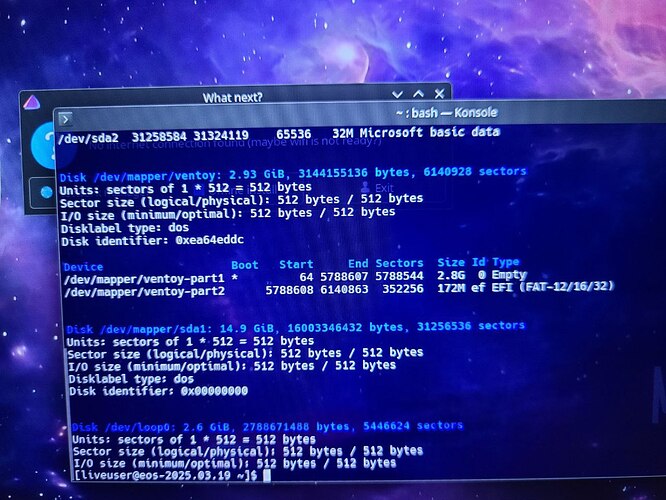

I ran that on the terminal in the live environment and this is the result… I have very little idea of what all that means XP
