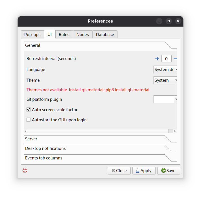

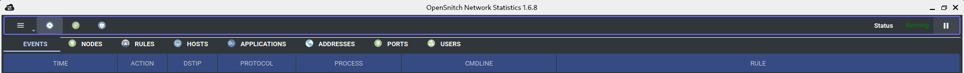

However using qt-material and theming the app from within the application’s settings “breaks” the GUI for me. The app is still functional but under the Events tab I lose a few of the columns which I find providing important information . Please have a look!
Before theming
After theming
Now the odd issue is that setting back the theme to system default will not bring back those columns. I guess it has to do with running a QT app on a GTK environment. I have to remove ~/.config/opensnitch and restart the app before I get back all the lost columns.

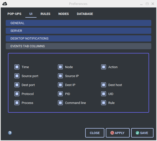

I tried again with python-qt-material. Looks like choosing a new theme, unchecked some boxes in the UI settings for “EVENTS TAB COLUMNS” Checking the boxes again, I get back all the columns. The whole UI looks still a bit off with the white titlebar but much better than what it was before.
Thanks @dalto and @thefrog for help and support!
