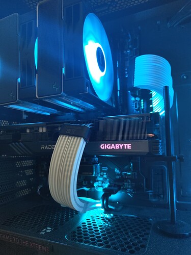

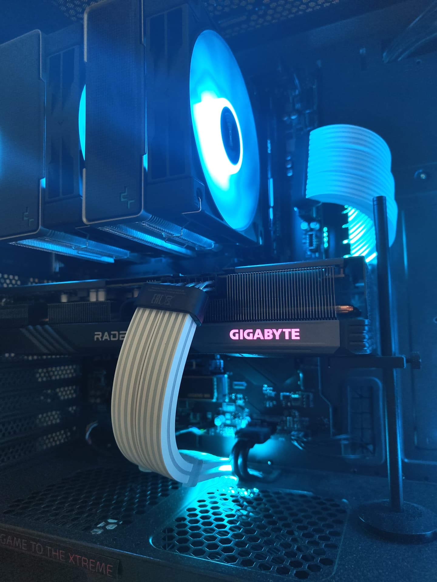

I installed OpenRGB recently and everything was working at first. But after 5 minutes of configuring rgb on my devices I noticed that instead of my mouse (G502 wireless) I have G915 keyboard although my mouse is in support list of OpenRGB.
Also when I was configuring ARGB on my motherboard (MSI MPG B550 Gaming Plus) I noticed that cable to MoBo and GPU don’t work on all length (photo will be below)
Should I open an issue or anyone knows how to fix this?
I would open an issue…
First: Try openrgb-git to see if it’s fixed there (this is recommended by openrgb)
Second: If that does not fix the problem, document everything in your system and submit a normal bug report.
Also: try changing to different headers (if you can) to see if that corrects your problem.
Thanks for the answer! I’ll try to plug the cables into a different argb header. Maybe it will help.
But about a mouse ig I’ll open an issue
You are welcome!!! I have had my issues (fixed by using openrgb-git)…Once openrgb is set up & running well, it’s great… Getting there is the main issue…
I forgot to mention I did install git version of openrgb. But it didn’t fix any of those.
So the only way now is to create a new issue…
Not a problem…did switching RGB headers have any effect?
I guess it did… But I think it was OpenRGB’s fault because when I chose Static mode instead of Direct all cables’ ARGB has started to work
