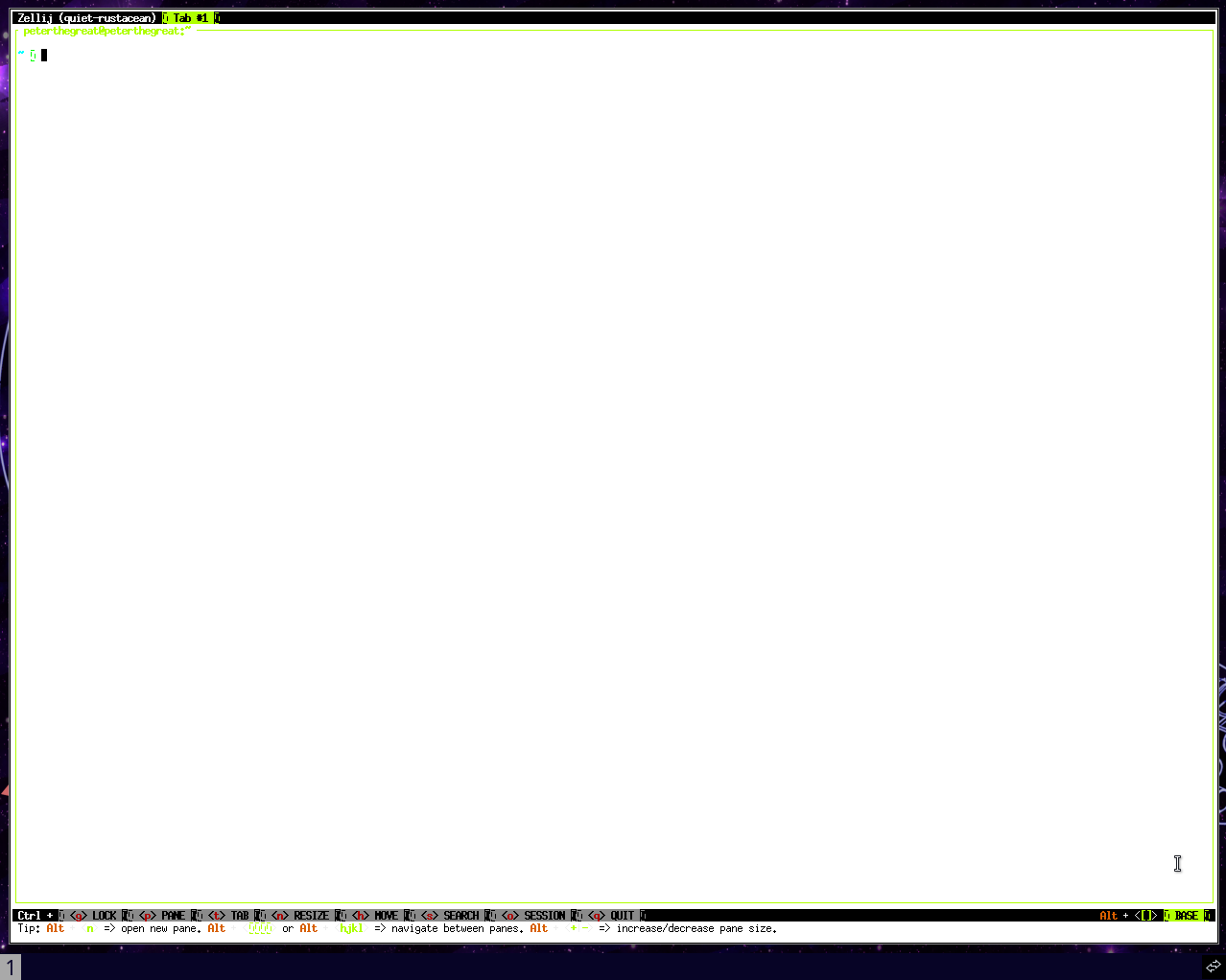

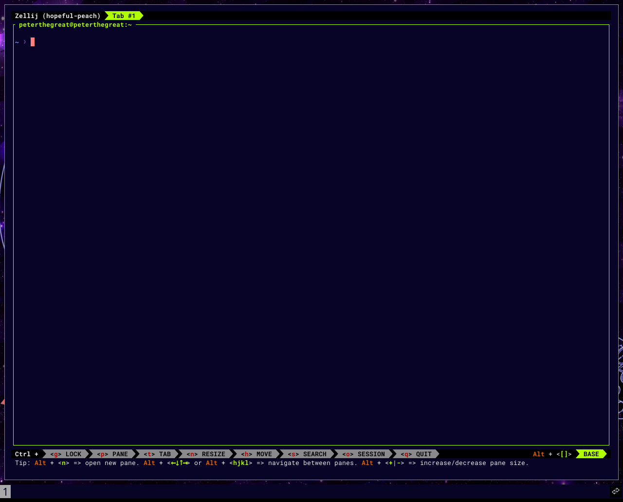

Hello,
Thanks for your help. I was looking at the config and I am unsure of whether rofi or dmenu is used. But i can tell you that the app does launch but the interface is completely different.
From terminal:
From dmenu or rofi:
Thanks

No i still haven’t solved it in the screenshots above it shows both versions.
