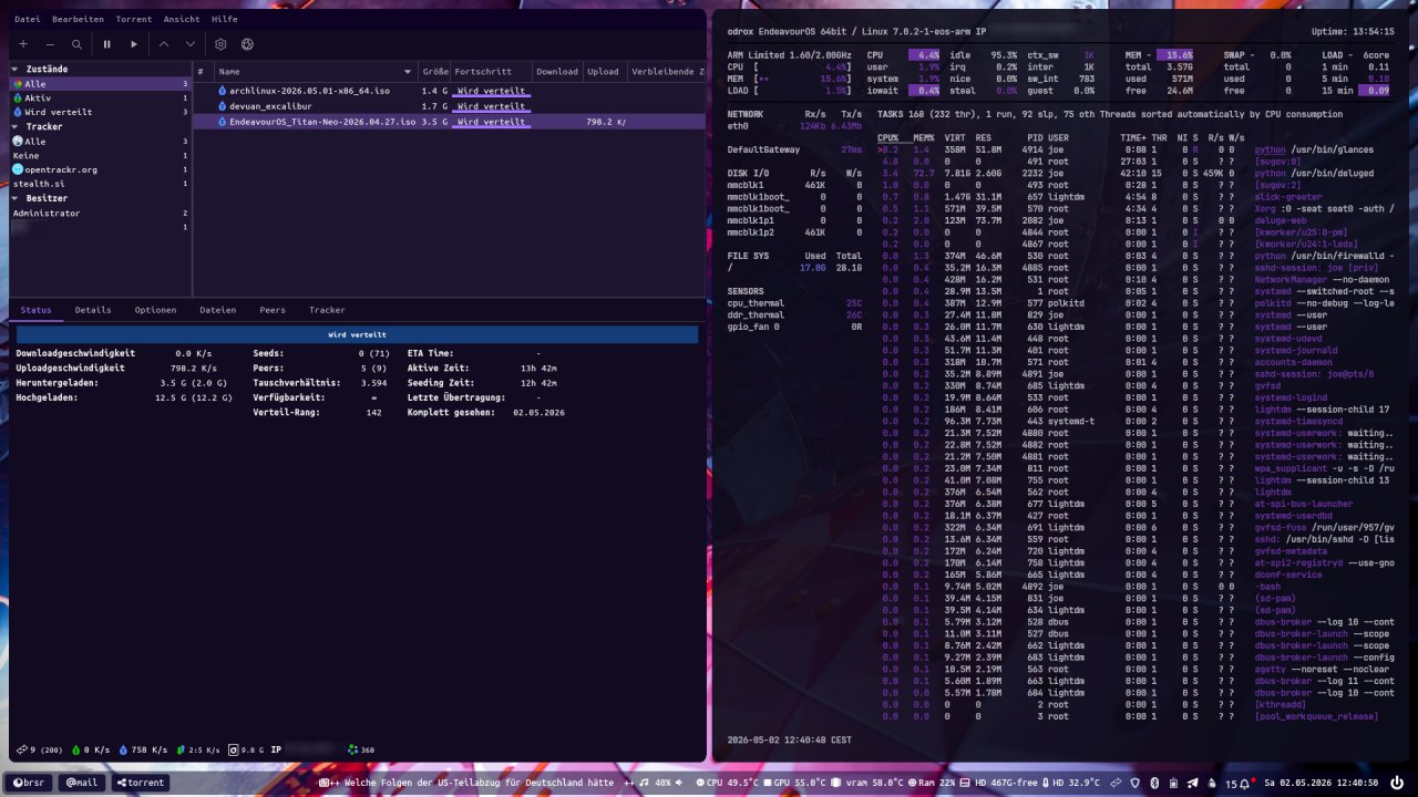

Using KDE to see if i got really the same, on my old install i can launch wayland session with kde using sddm set to use wayland session and also with plasma-login-manager
just updated to latest kernel, still working fine .. currently using the odroid to seed ISO torrent..
pic is remote access from my main system..
