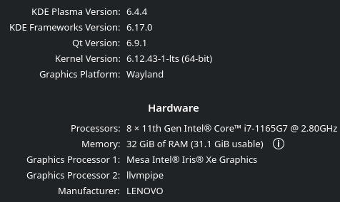

I have thinkpad E15 Gen 2 with NVIDIA GeForce MX450 configured with envycontrol in hybrid mode `sudo envycontrol -s hybrid --rtd3` with proprietary nvidia drivers. it’s not entering D3 power saving mode although nothing is apparently running on that. not even X11, (because I have removed /usr/share/X11/xorg.conf.d/10-nvidia-drm-outputclass.conf to prevent X11 from using nvidia )

I am running Endeavouros with KDE plasman with Wayland
