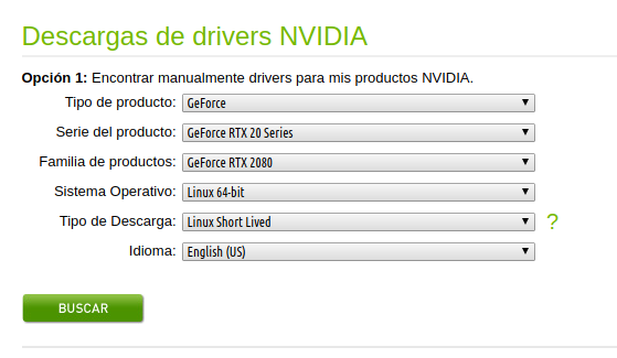

@joekamprad@AmokPaule I didn’t even realize that tool was there and able to update directly from Nvidia! I know my card also wasn’t in the list originally but got joe to add it. Maybe we need this info added to the wikki?
That’s it but with the short lived driver. For some reason the nvidia-installer-dkms didn’t pick up the card when he ran the installer. So he ran nvidia-installer-update-db which i didn’t know about and i was just asking if this automatically runs before trying to install a driver? I ran it on my system to see what it did as i was curious. It connects to Nvidia and updates by the looks of it.
