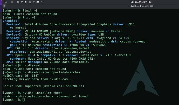

Since several days i was trying to figure out what Nvidia drives should i install and how to install them. Then today i suddenly found out i have the nouveau drivers already installed on my system i don’t know how they came on my EOS system. SO CAN SOME ONE TELL HOW TO REMOVE NOUVEAU drivers safely and install the nvidia-dkms drives for my GPU so its is up and running nicely. HELP will be appreciated from the bottom of my Heart.

nvidia-inst does not blacklist anything, but nvidia-dkms or nvidia should blacklist nouveau.
