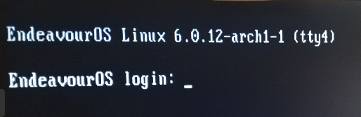

Things get complicated. now the upload of the live stops after the welcome and a flashing cursor appears.
After several attempts (Ctrl+Alt+F2) it appears:
[url=https://postimages.org/][/url]
How can I continue?
You can login there with your username and password.
If you installed the 390x drivers without switching to the LTS kernel, that would be the expected behaviour which I warned you about above.
If that is the ISO, you need to choose the open source option. The nvidia option won’t work with your hardware.
Maybe I didn’t explain well.
The writing tty appears while loading the live usb.
Too many problems surely caused by my inexperience.
I think I have to leave EndevouOS and switch to other OS.
Thanks anyway for the help
It was understood.
Did you select Open Source drivers?
Yes, I chose Open source drivers and it crashes exactly at the same loading point as the live.
I also downloaded a new ISO and prepared another live usb, but it stops at the same point as well.
would like to be able to install the s.o. in another partition on a separate disk. but I can’t upload the live anymore :worried:
This doesn’t make any sense to me. You boot on the live ISO and you can select latest nvidia cards or the default entry. If it boots on the default entry it should still install with nouveau open source drivers. If you boot on latest nvidia card and it boots it will install with nvidia drivers if your card supports them.
