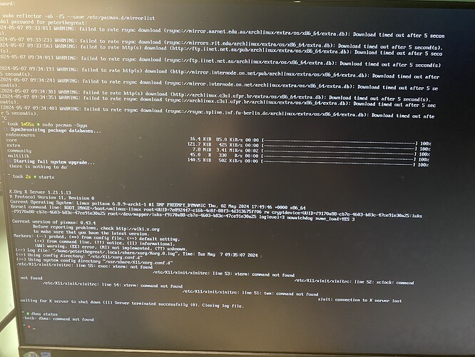

Today I booted into my OS but only one of my monitors was on I updated the system and rebooted to see if the issue went away. However, after the reboot there were no monitors. After logging into the tty I got this output when trying to start x server.
Is this normal?(errors regarding x not found) I believe that x should be present. I use i3 but I don’t think that is relevant.

Ps I get through the entire boot process correctly but when I have to enter the display manager to log in my monitors start flashing in grey.
there is error on mirrors , can you recheck before ,
remove any lock and confirm update ending ?
Hello,
I changed the command to update mirrors and it worked. But I still have the same issue.

Hello,
This is message I get after looking for xorg and xorg-init in the system.
After installing xterm starts works.
