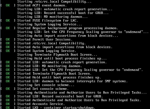

eg. like this one (random image from the internet for representation, and not from my actual PC) , but for shutting down/rebooting procedure
