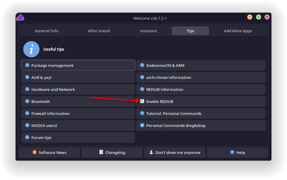

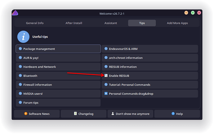

sounds like you need to reinstall your bootloader I do believe its bootctl install for systemd-boot (make sure you mount the efi drive before doing so) also you should always try to REISUB before physically shutting down.
Can enable through the welcome app these days too.
