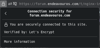

and install certbot from Let’s Encrypt.
Let’s Encrypt is what EndeavourOS Forum uses for https certification and I use it for my personal web browser.
It is free and worth the effort.
