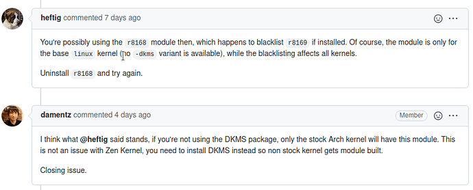

You should have a look at this issue:
Specifically the last comment from the linux-zen maintainers:
EDIT:
In a nutshell: If you insist on using the r8168 module for linux-zen you need to install the dkms package: aur/r8168-dkms
Thank you there is a blacklist file on modprobe folder, its why i cant get it working when i uninstalled it earlier when @Kresimir suggested it, after removing 8168 + blacklist file, now all is working.
I guess its not a bug with zen or eos, just something users have to keep watch on.
