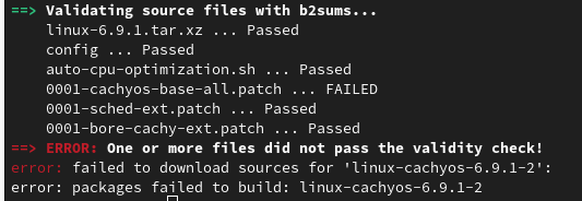

Screenshot from 2024-05-26 14-15-15
G’day everyone, I’ve dilly-dally-ed into linux for quite a while. Mostly ran fedora and nobara. Only other custom kernel I had installed was zen and it went smoothly.
Figured I’d learn arch and installed EOS. I’d like to install cachyos kernel on my system. I found it on AUR, getting an error when I try to install it using yay.
Is there anyway of installing cachyos kernel without installing their repositories? While I was doing my research I read installing cachyos Repos might break alot of things, I’d like to avoid that.Please help.
Cheers
That is an issue with the PKGBUILD. You should report it to the AUR maintainer.
Thank you, will do!
