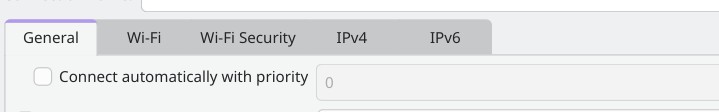

If you the issue is with a WiFi connection, then in KDE, there is an option, “Connect automatically with priority” that has to be unchecked. Please refer to the screenshot given below. If this check box is selected and the WiFi SSID is being broadcast then the connection will happen automatically.
Now if the router has no internet and WiFi SSID is broadcasting then also the connection will happen. Ditto for wired LAN connection.
