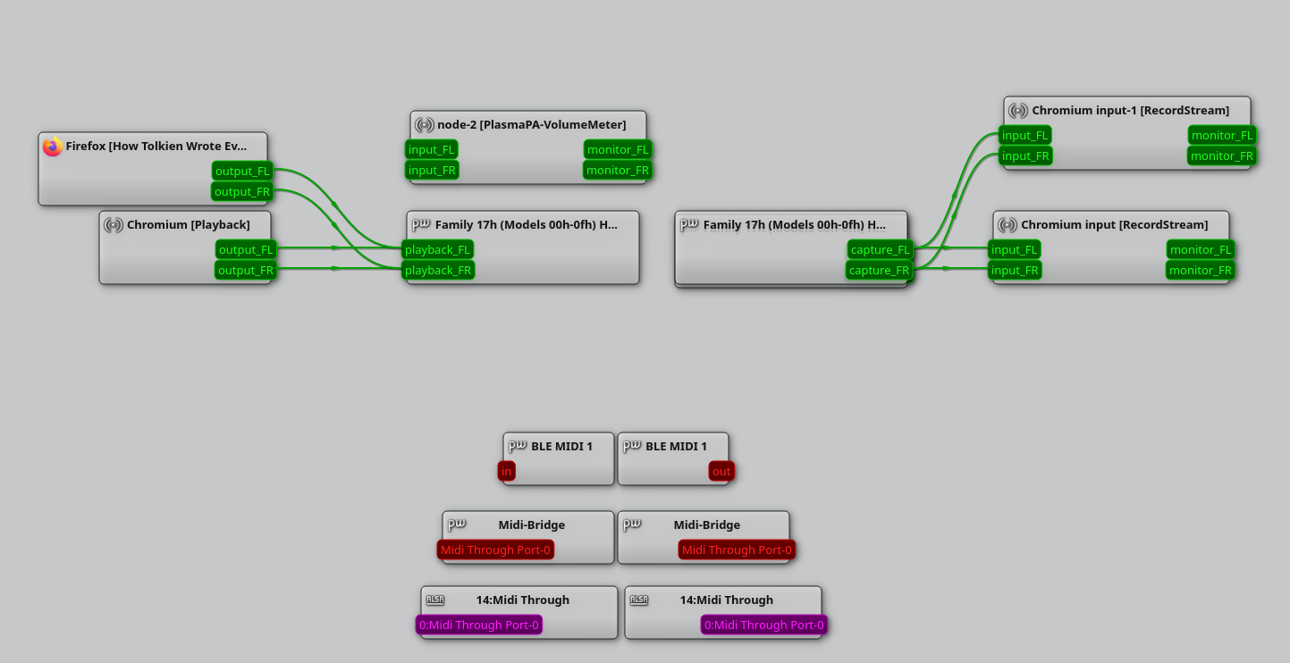

I installed qpwgraph without doing anything else. And, after organizing a bit, I got this graph:
Headset/line and mic seem to have different devices, but there is still this reproduction of sound from one device to the other. There is nothing to disconnect here, so I’m not really sure what to do with the GUI itself.

I did what it says on the repo and I played with the new nodes on the graph. It doesn’t seem to do anything different.
I now realize this makes sense, because this never happened when I listened to an instrumental-only music video, so “noise” is certainly being suppressed, but not voice-like audio that’s being broadcasted to the mic. So, in essence, I don’t think the noise suppression route is gonna work for this.
I think I’d need some kind of filter that eliminates the whole system audio on the mic, if I can’t avoid this system audio being sent into the mic in the first place. I’m starting to think this won’t get solved.
