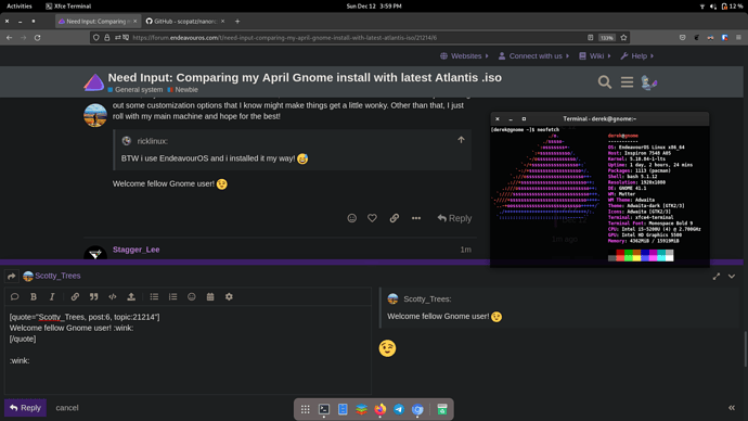

Welcome fellow Gnome user! :wink:
Yes, but I think it’s better if I keep them to myself :grin:.
:wink:

I guess we’ll see:
Screenshot from 2021-12-12 16-06-22
Feel free to spill the beans :wink:
You need 1TB on Gnome with all those extensions and Gnome extras! :rofl:
Yeah, looks like the new python update from unstable finally hit us. Probably gonna have to rebuild a few of my AUR packages when I update that!
