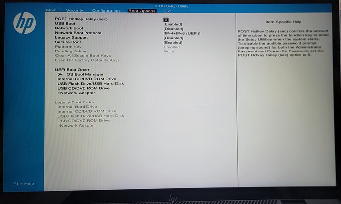

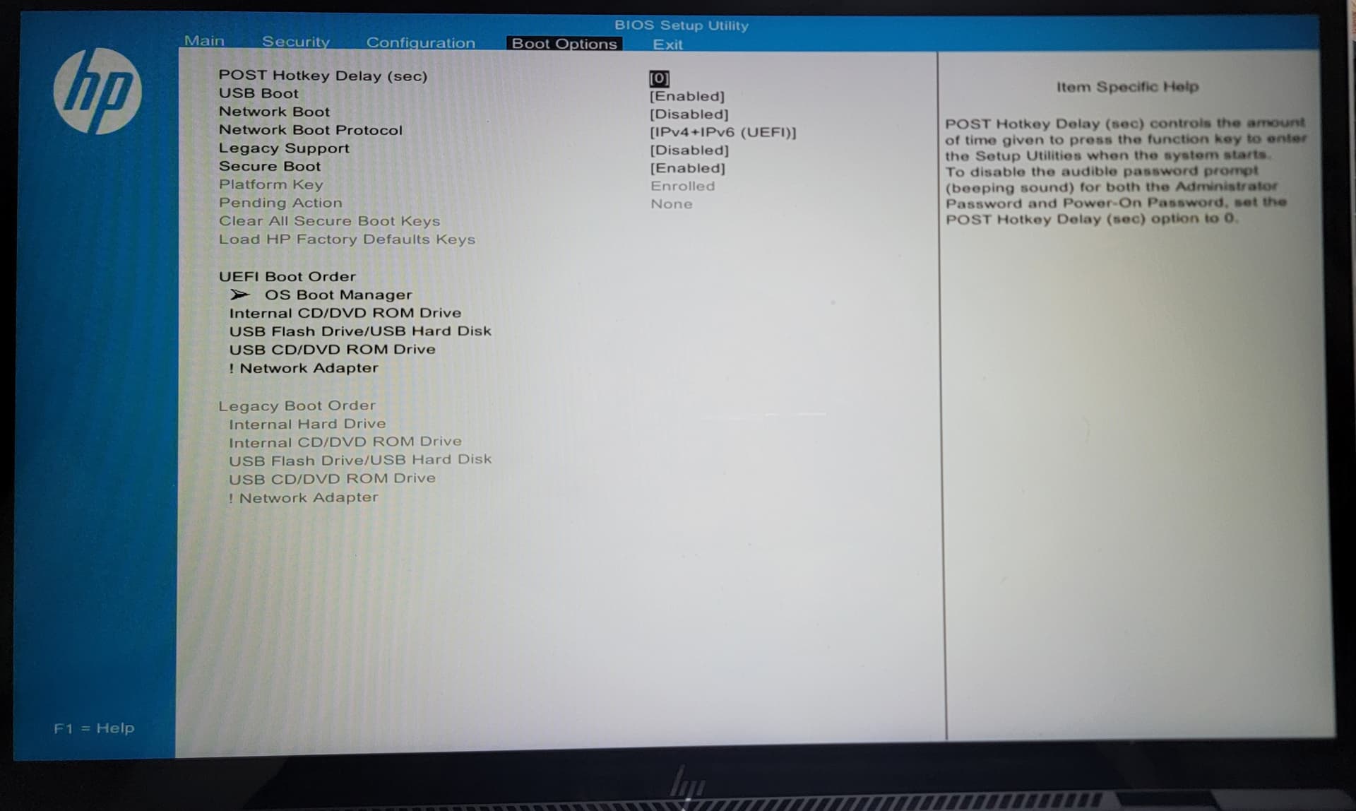

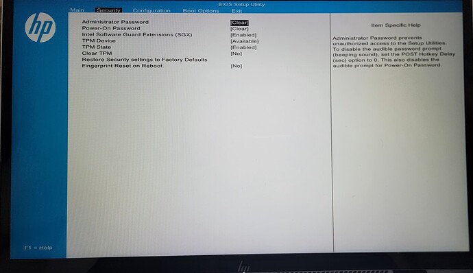

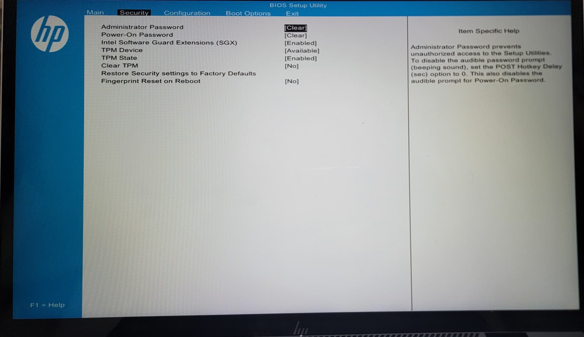

Secure boot say’s it’ enabled and should be disabled.
Edit: This shows Windows 10? Are you dual booting with Windows? If so you need to turn off fast startup in Windows under power management.

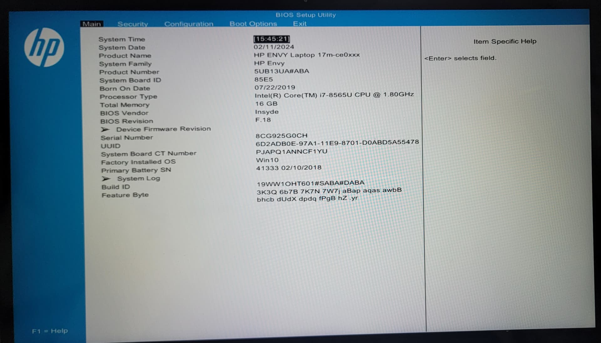

I play valorant, I enabled it to play then booted into BIOS to capture screenshots for you.
Yes, I installed it to play valorant, 2 days ago. So it wasn’t there before. I am gonna disable fast startup and check if nouveou works, because it didn’t when I tried installing it again.

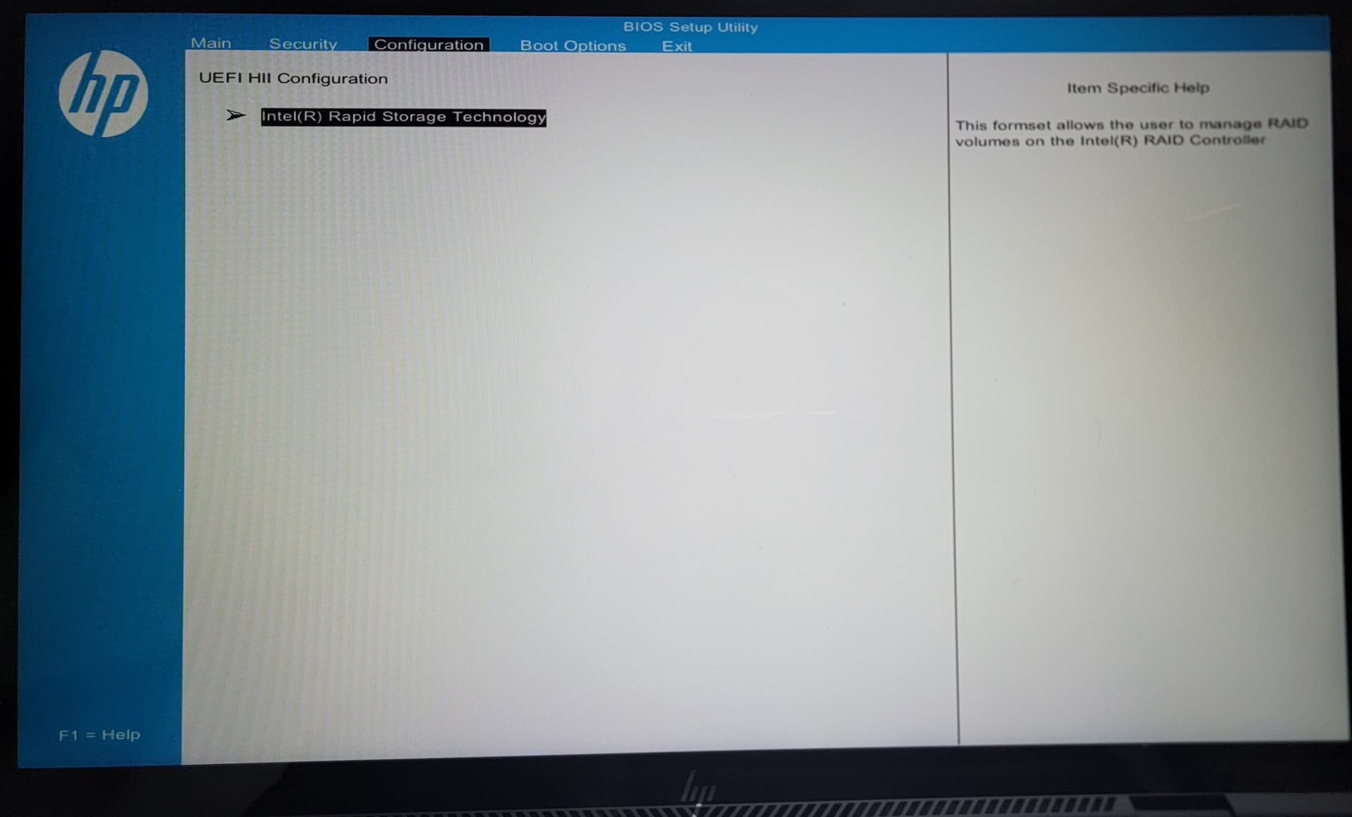

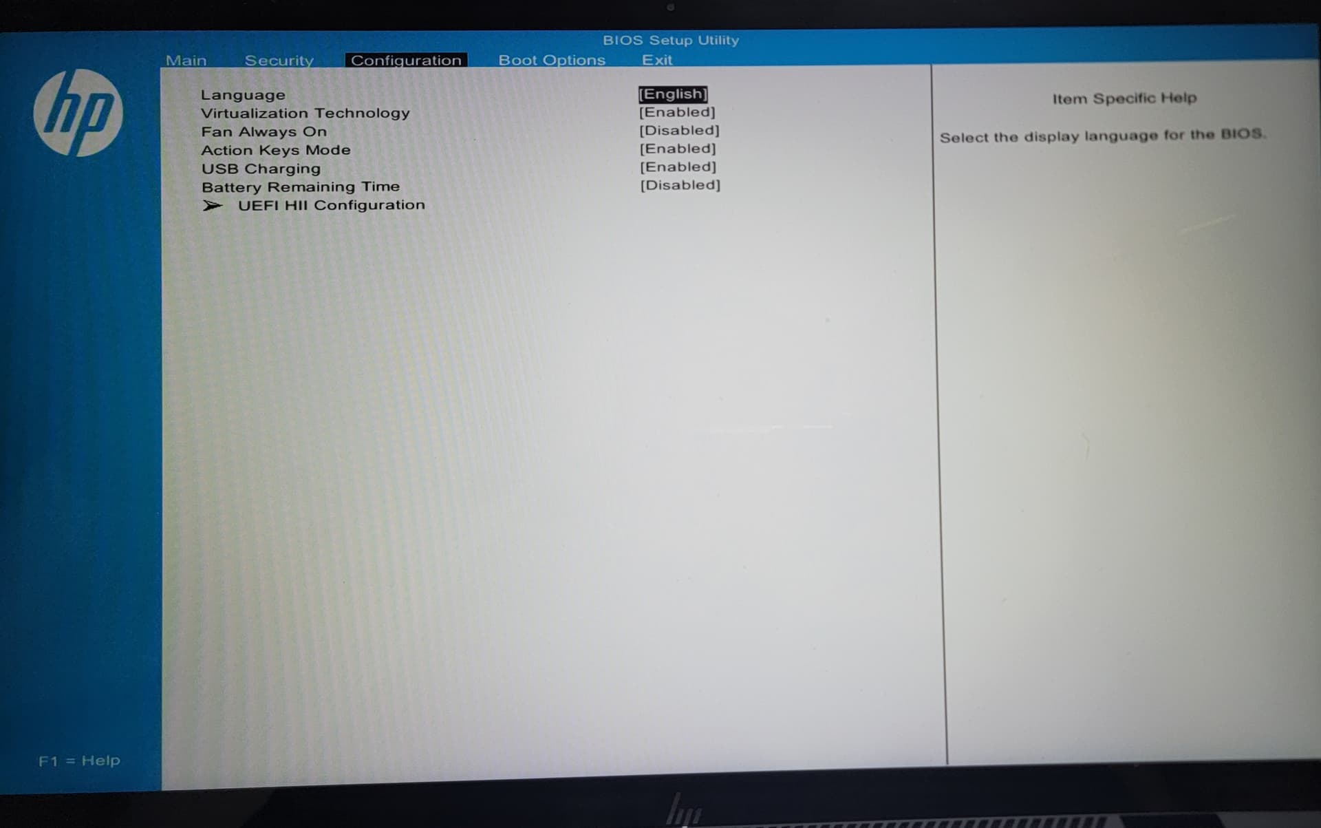

It doesn’t show anything related to the graphics that i see. I just looked up the specs on the laptop based on the serial number provided in the UEFI images and this laptop does not have an nvidia mobile graphics card. Can you confirm that this is the correct model and serial number.

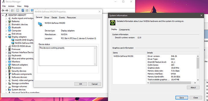

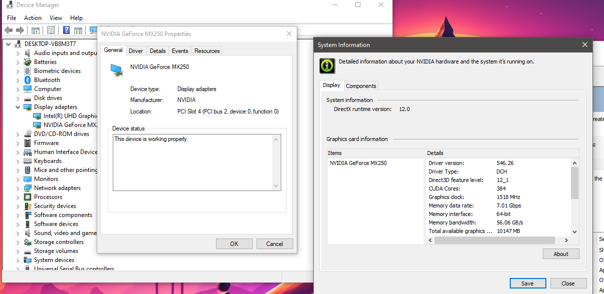

Yes this is the exact model, It’s an error on HP’s side I believe.
Weird… doesn’t show an nvidia card in the specs. But it does show from your log with the bus error.

Yes i believe you but it’s just weird that the specs show even when looked up with the serial number of the product that it doesn’t have nvidia. :rofl:
:joy::rofl: Yea I didn’t blame you but same it’s weird af lol.
