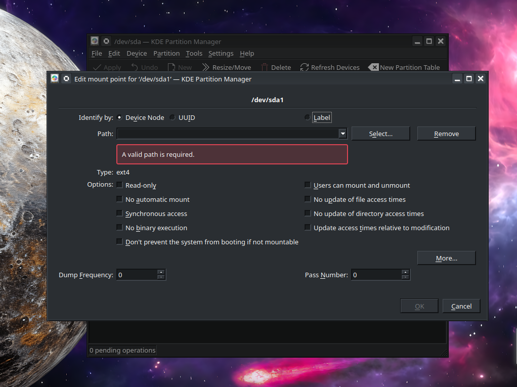

Yes, it’s the 1.8TB sda that I want to use. Will I still have to manually create a mount point in the fstab file if I use the partition manager or will it make one automatically?
You have the ability to right-click a not-yet-mounted partition and “Edit Mount Point”, which will add it to fstab :+1:

Just to clarify I should add a new partition to the sda and then edit mount point? Nothing else I need to do?
Should the path be set to the fstab file? Do I need to make it UUID or anything else?
The “valid path” just needs to be the mount point. For example, I have an 8TB SSD that holds all my steam games. I formatted it for btrfs using KDE Partition Manager, and then edited the mount point. I used “/mnt/games”. If selecting “Don’t prevent the system from booting if not mountable” that must means the bootup won’t puke if not auto-mounted. I DEF recommend the “No Update of file / directory access times”. That’ll avoid unnecessary writes.
You’ll get an “are you sure you want to overwrite FSTAB?” I hate that message, it does NOT overwrite, it just appends it. So ignore that warning.
Then, when you reboot, it’ll automatically mount in the future.
