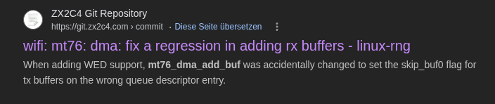

for the second time I got the following kernel panic (link) while working in virtual box guest (WIndows 11). If I’m not mistaken, the dump seems to point towards a module function “mt76_dma_add_buf” (please correct me if I’m wrong) for which there seems to be an error report here.

  1. do I read the dump correctly or is the fault elsewhere?
  2. if indeed the problem comes from the mentioned mt76 WiFi driver, how can I find out if the patch is or was installed, or how I could install it
  3. since I do not necessarily need WiFi (since I also have Ethernet), how could I remove the mt76 driver?

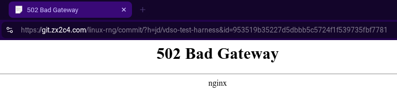

The error report seems to be failing:
As @ricklinux noted, have you tried using the Ethernet and disabling WiFi? If the issue does not persist, one could then assume the issue was the mt76 driver, which answers your question.
Well I don’t know why we’re getting a Bad Gateway now, since it was working the other day and the error report is still visible on Google Search:

Most (but not all) the repositories on that site seem to be failing, so it looks like they’re dealing with bigger issues :man_shrugging:
