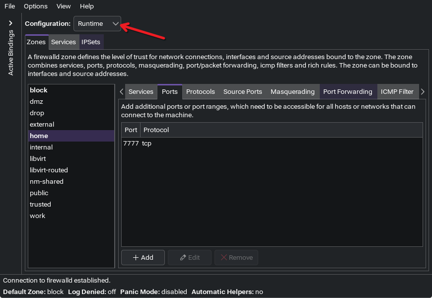

When I do this for games, I just ensure I’m applying any firewall rules to the runtime configuration, and not the permanent configuration. That ensures the next time I boot up, those changes are not retained.
You can also do a similar thing on the command line, if you’d like to make it a part of a script. For example, temporarily unblocking TCP port 7777 in the home zone, would look like this:
sudo firewall-cmd --zone=home --add-port 7777/tcp
