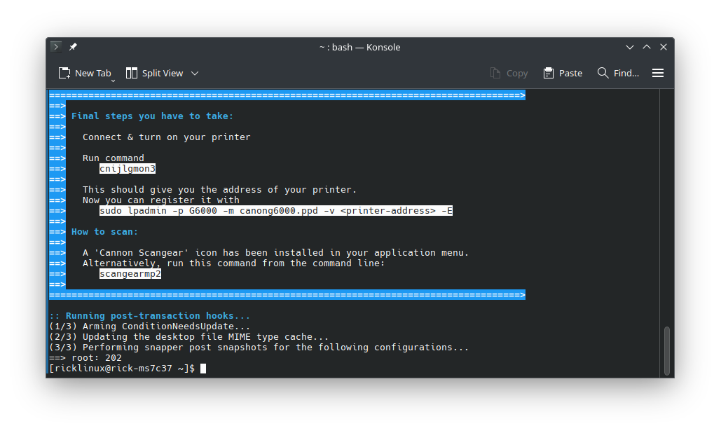

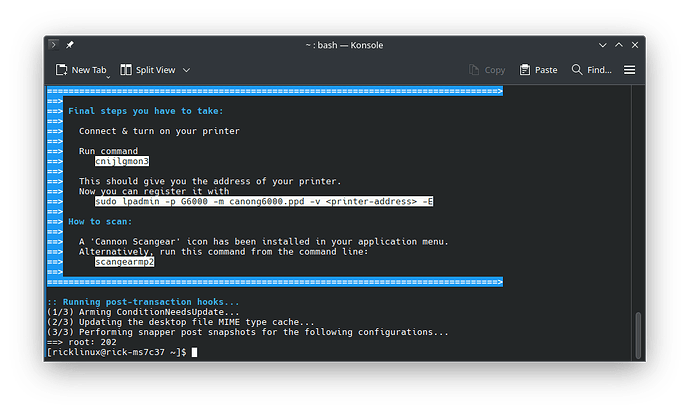

I ran the package build and at the end it shows this:
Final steps you have to take:
==> Connect & turn on your printer
==> Run command
==> cnijlgmon3
==> This should give you the address of your printer.
==> Now you can register it with
==> sudo lpadmin -p TS5055 -m canonts5000.ppd -v -E
==> How to scan:
==> A ‘Cannon Scangear’ icon has been installed in your application menu.
==> Alternatively, run this command from the command line:
==> scangearmp2
I don’t have a printer to hook up and test. But it does look like it built the package for the printer.

==> Final steps you have to take:
==> Run command
==> cnijlgmon3
: Post-transaction-Hooks werden gestartet
