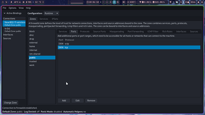

  • i added the ports in firewalld (im not sure if i did it right see screenshot)

I know diddly squat about workbench, but in firewalld shouldn’t the ports be “trusted”.
You just made me realize that i send the same screenshot twice and didnt specify that i tried both trusted and public bzt thank you
