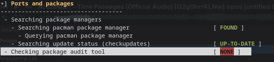

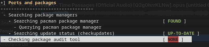

this means almost nothing, right? if I wanted a cve tool I should get it myself? Is that what I’m seeing?

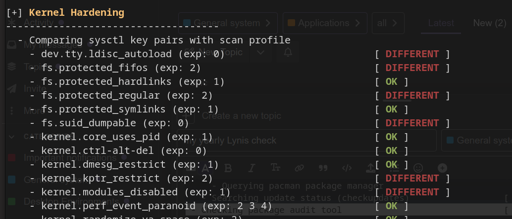

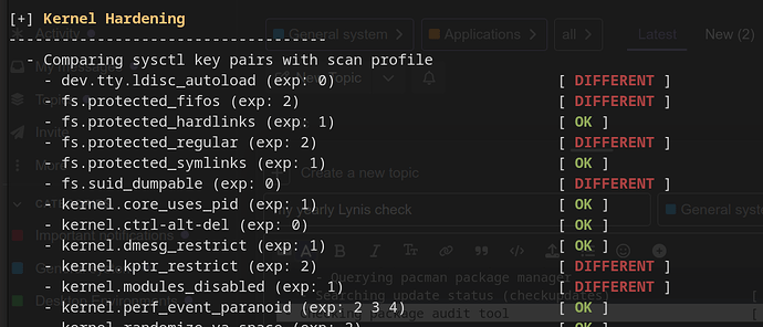

also in the kernel section a lot of “different” than expected which seems harmless:

About the package audit tool, it is looking for auditd or equivalent to be installed. That will help to determine which application and which package had done what. Please do note that auditd will create humongous log files inside the directory /var/log/audit. One has to be proficient in understanding the audit log files created by auditd.
It is a good to have. If you are running a server, a definite/mandatory yes. If running a desktop, then yes would be good to have. Recommendation is to have it.
These are kernel hardening parameters. With the expected value, i.e. exp.
