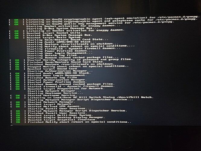

This almost worked i guess, past the previous error, now stuck here for few minutes:
Sorry i don’t know how to copy this.

sudo mount -o subvol=@ /dev/sda2 /mnt
sudo mount -o subvol=@cache /dev/sda2 /mnt/var/cache
sudo mount -o subvol=@log /dev/sda2 /mnt/var/log
sudo mount -o subvol=@home /dev/sda2 /mnt/home
sudo mount /dev/sda1 /mnt/boot/efi
sudo arch-chroot /mnt
In chroot:
pacman -Syyu
Brooooooo :heart::heart::heart:
Thanks for having the patience and the knowledge.
