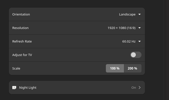

I’ve turned down the refresh rate. I have lower intensity flashing (the red flashes on the bottom of the screen and not the lower half). Still not good enough though.
