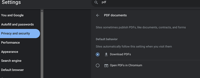

Chromium settings–nothing to see here:

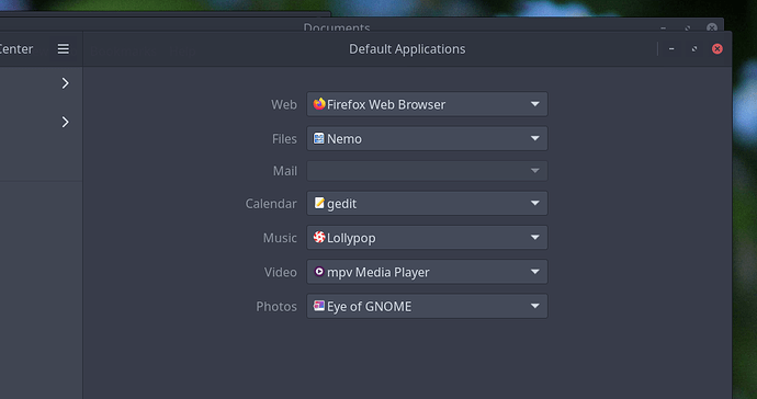

behold default apps:
NO PDF! :frowning:
remember, double-click = chromium. How to change, man?

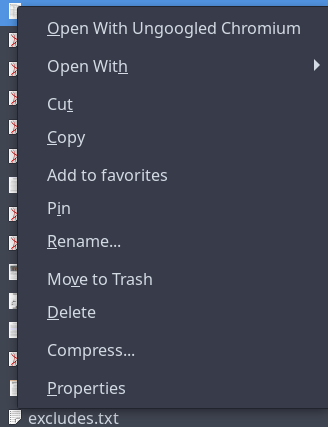

right click

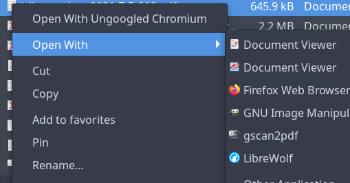

open with:
rightclick2

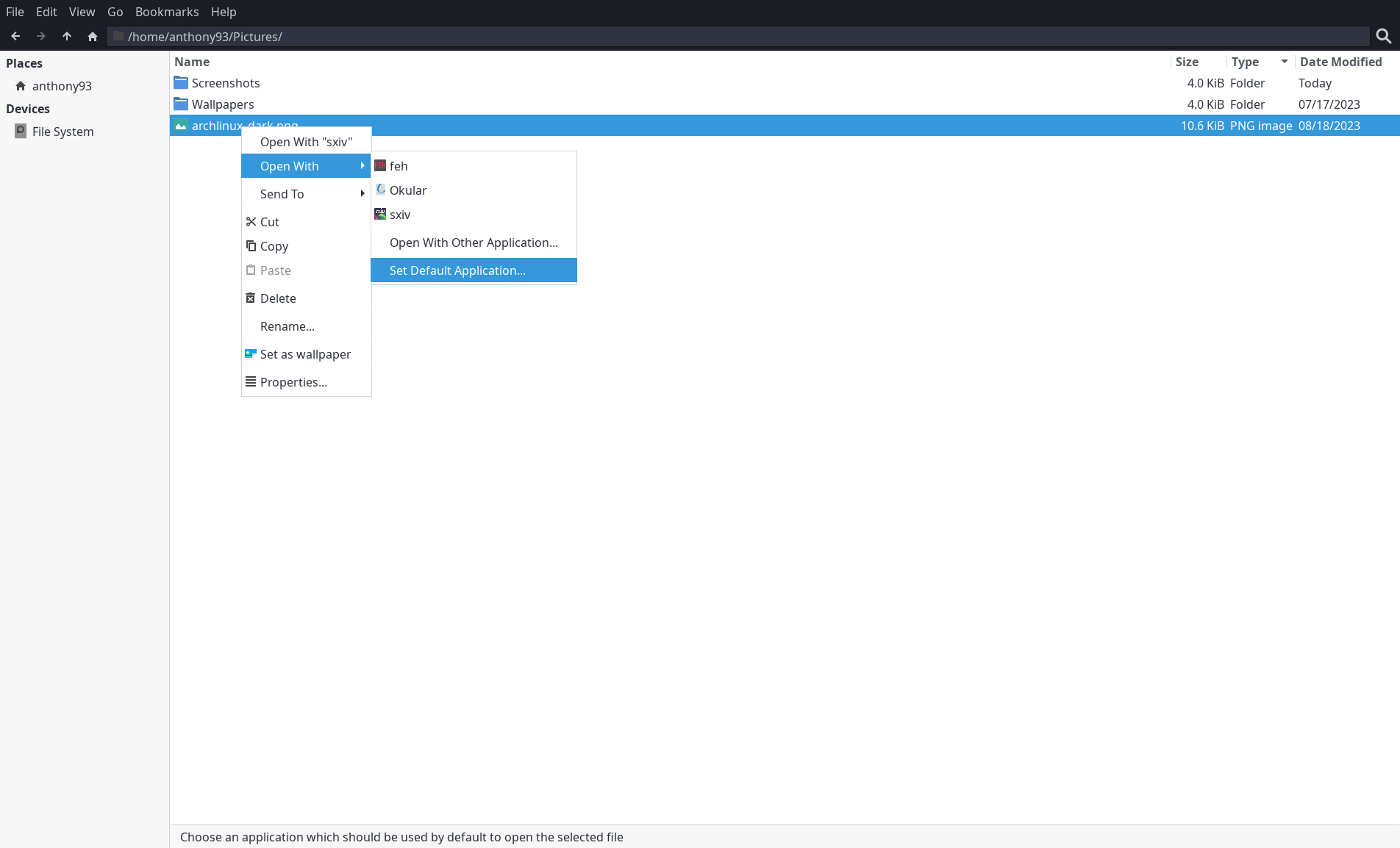

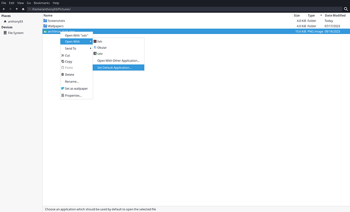

Since you are using Thunar file manager, you should be able to see another item called “Set Default Application” in this context menu. On my system, it looks like this:

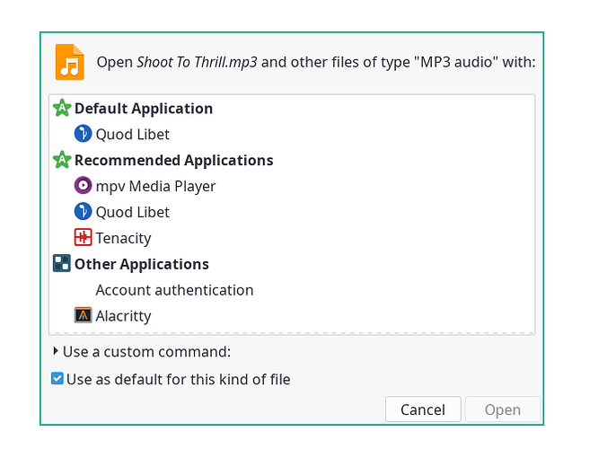

Clicking on that item should open up a pop-up window that looks similar to this:

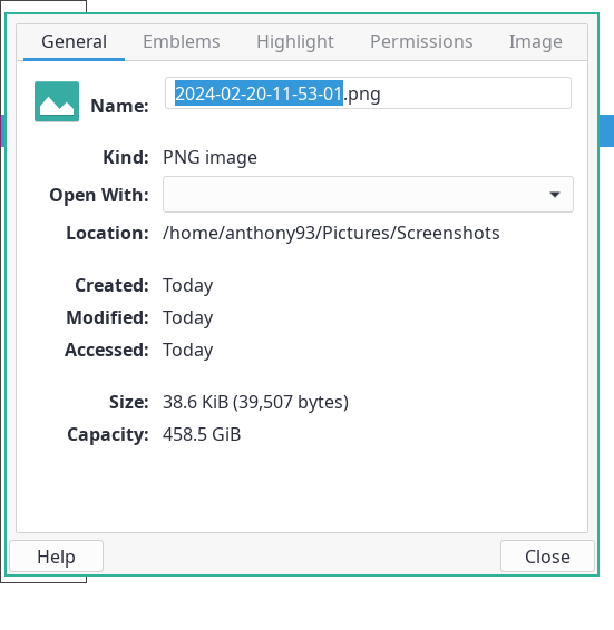

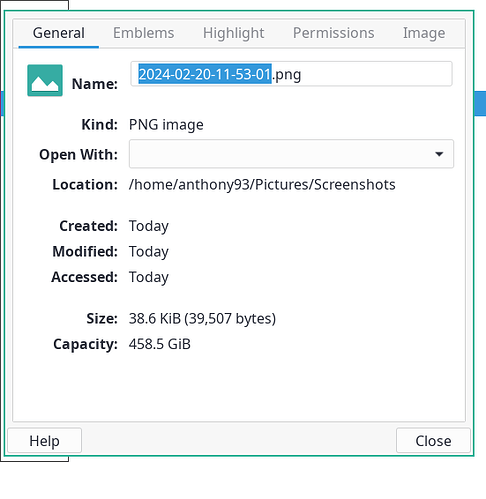

You can also do this by clicking on the “Properties” item, which will bring up another menu like this:
