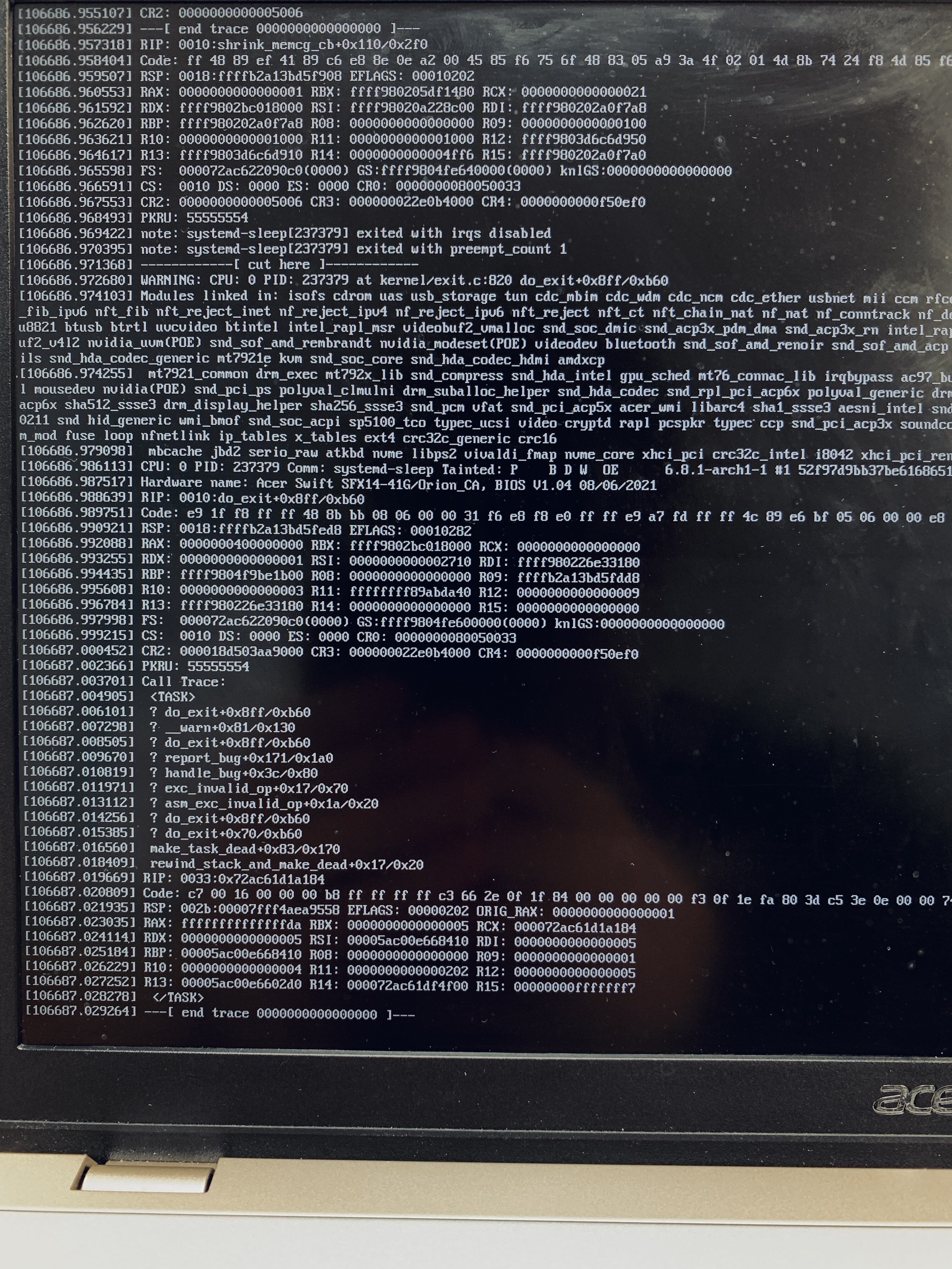

Today, I closed the lid like any other time to take my laptop with me, and not even 15 minutes later when I opened it again, all it displayed was this screen:
Nothing on the keyboard does anything, (except for fn+f6, which just blacks out the display) and I cannot hold the power button to shut it down. Nothing on this screen changes or has changed for the last 30 minutes. If I close the lid, the screen blacks out as well until it’s opened again, and the screen comes back. I can also hear the fan faintly spinning. I also tried plugging in a usb stick that has my EOS install, and it changed nothing. I don’t have the charging cable on me at the moment but I will update later what happens when I plug it into power.
Update: still don’t have charging cable but it’s pretty warm. Don’t know why
Update: The battery ran out and it finally shut off. After plugging it back in and turning it on, (currently powered off now) everything was back to normal. I really don’t want this happening again, so can someone help explain what happened and what I should do? Also, how and where do I get system logs that might give more insight as to what happened?

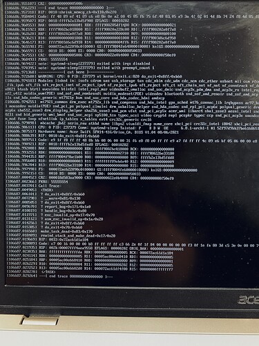

I assume this screen has something to do with the kernel, but I am not proficient in the linux kernel or system basically at all, so I’m not sure what I’m looking at. I googled for a while, looking for similar issues, but everything I found either matched (partially) what my laptop was showing but had no solution, or didn’t apply to my situation.
What even happened and what do I do?

In my other update, when the battery died and I restarted it, it worked completely fine. Today, it happened again, but this time was worse because instead of freezing on some weird kernel screen, it just froze on the desktop, and the fans were blasting and it was getting very warm. I turned it off through the battery pinhole on the bottom. What the hell is happening? This is frustrating, and I have not seen anything like this online.
Should be worth looking into the logs. journalctl -b-1 shows the last boot, try to figure out what happened before the lockup by looking at the end of the log.

There are issues regarding the proprietary Nvidia drivers/modules, people reporting kernel crashes/segfaults panics too … i had similar condition too where ddcutils was involved in relation to nvidia drivers.
It was not happening if i was going to remove nvidia drivers and modules.
But this issue seems to be resolved at least partly… make sure system is up to date, and check if the same happens when running LTS kernel. (ask if you need more info)
