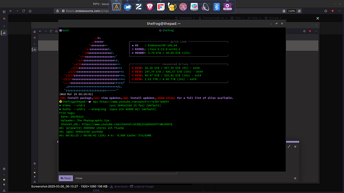

@thefrog
Would you be willing to test with an AV1 video to see if it works for you?
Here is a link to an “innocent” video. It’s about photography.
https://www.youtube.com/watch?v=ioJDriq9OIY
works fine
Thanks!
We seems to have similar GPU. If it works for you, then it is something on my end :unamused_face:
I’m running Openbox if that helps. Seems the only diffrence in our Video is the Vendor

It will play fine, but just always using the software decoder. This GPU just doesn’t have AV1 hardware decoding.

Looks like I get VP9 and hardware decoding though no audio this time :grinning_face_with_smiling_eyes:
Here is the output:
mpv --ytdl-raw-options=format=bestvideo[ext=webm] https://www.youtube.com/watch?v=ioJDriq9OIY

Both looks to be working fine!
● Video  --vid=1  --vlang=eng  (vp9 3840x2160 25 fps) [default]
● Audio  --aid=1  --alang=eng  (opus 2ch 48000 Hz) [default]
