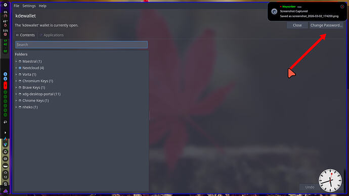

I use hyprland. That is not default, i realize that but perhaps someone can help here because this is maybe more generic. Applications like cryptomator constantly ask for kdewallet rather than hyprpolkitagent (i do have it started with systemctl in exec-once directive in hyprland.conf). For example extra SSDs i have ask through hyprpolkitagent. I couldn’t find a way how to unify this. When i installed Endeavour, it did that with KDE so that’s where kdewallet originates.

This probably depends on the app. I only have (1) app that asked for a wallet (VPN client); everything else uses hyprpolkitagent.

Well it’s all good tbh. So what one program asks for kde, other for hyprpolkit, it’s not really end of the world. It’s a little weird but yea.
It gets me thinking if i decided to remove KDE what kind of problems would that cause (potentially).
i see from yay -SSi polkit-kde-agent that only plasma-desktop and plasma-meta depend on it. So i removing it would most likely cause whole KDE to be removed. And those 2 are not required by anything… Interesting…
