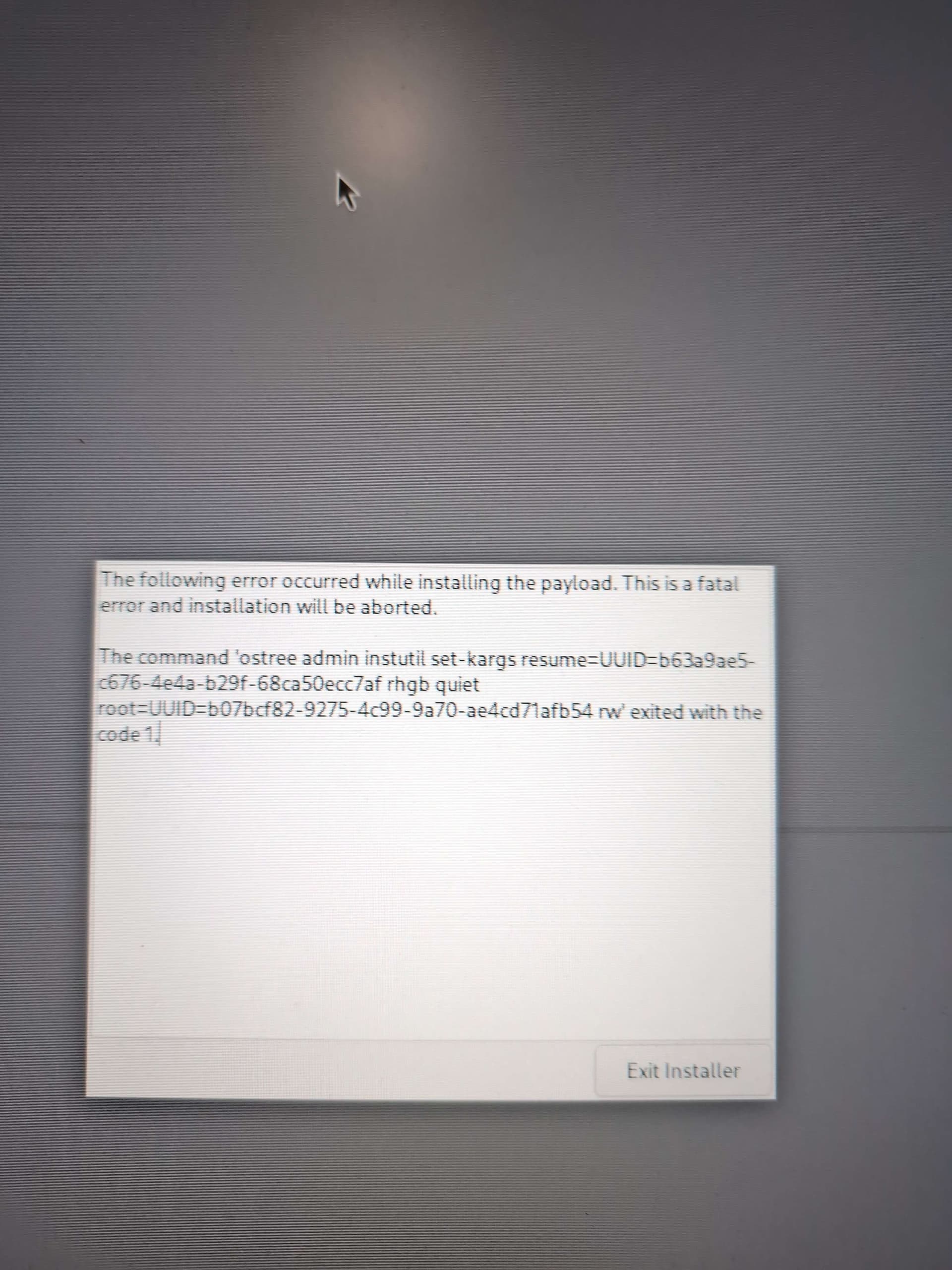

I need the original GRUB for Bazzite as it has its own rollback features, and its GRUB needs its own partition, lest you want it to give an error on install due to UUIDs

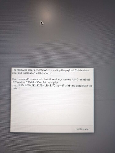

Here’s a picture of the error Bazzite gave me last time. The maintainers said that dual-booting alongside another Linux distro is not supported, forcing me to have rEFInd to discover the grub menus of each distro, in order to keep EOS and Bazzite fully separate.
