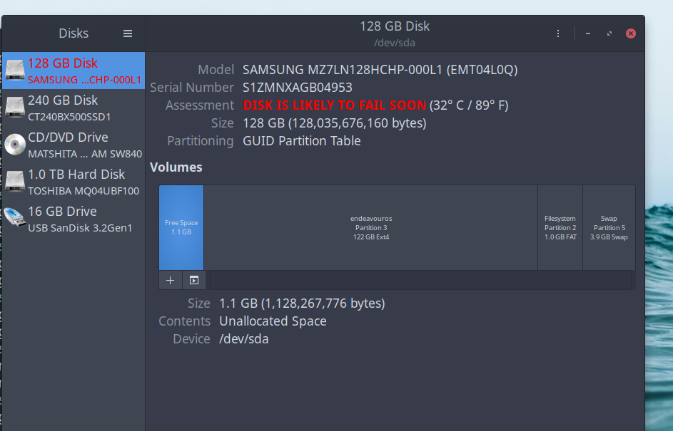

This is Endeavour SSD at present:

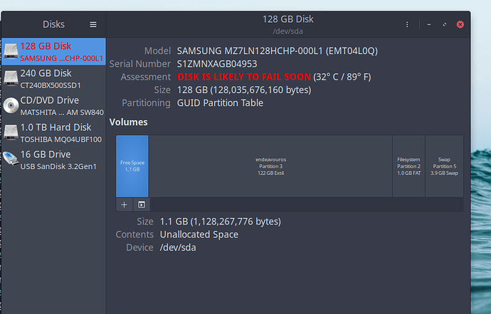

This is the gnome-disks Endeavour view from Solus (separate SSD).
Endeavour looking at itself in gnome-disks is identical picture.
I guess that’s two opinions but with the same app across two OS’s…so not sure I’m trusting the message here. Gparted says nothing…

SMART overall-health self-assessment test result: FAILED!
Drive failure expected in less than 24 hours. SAVE ALL DATA.
See vendor-specific Attribute list for failed Attributes.
