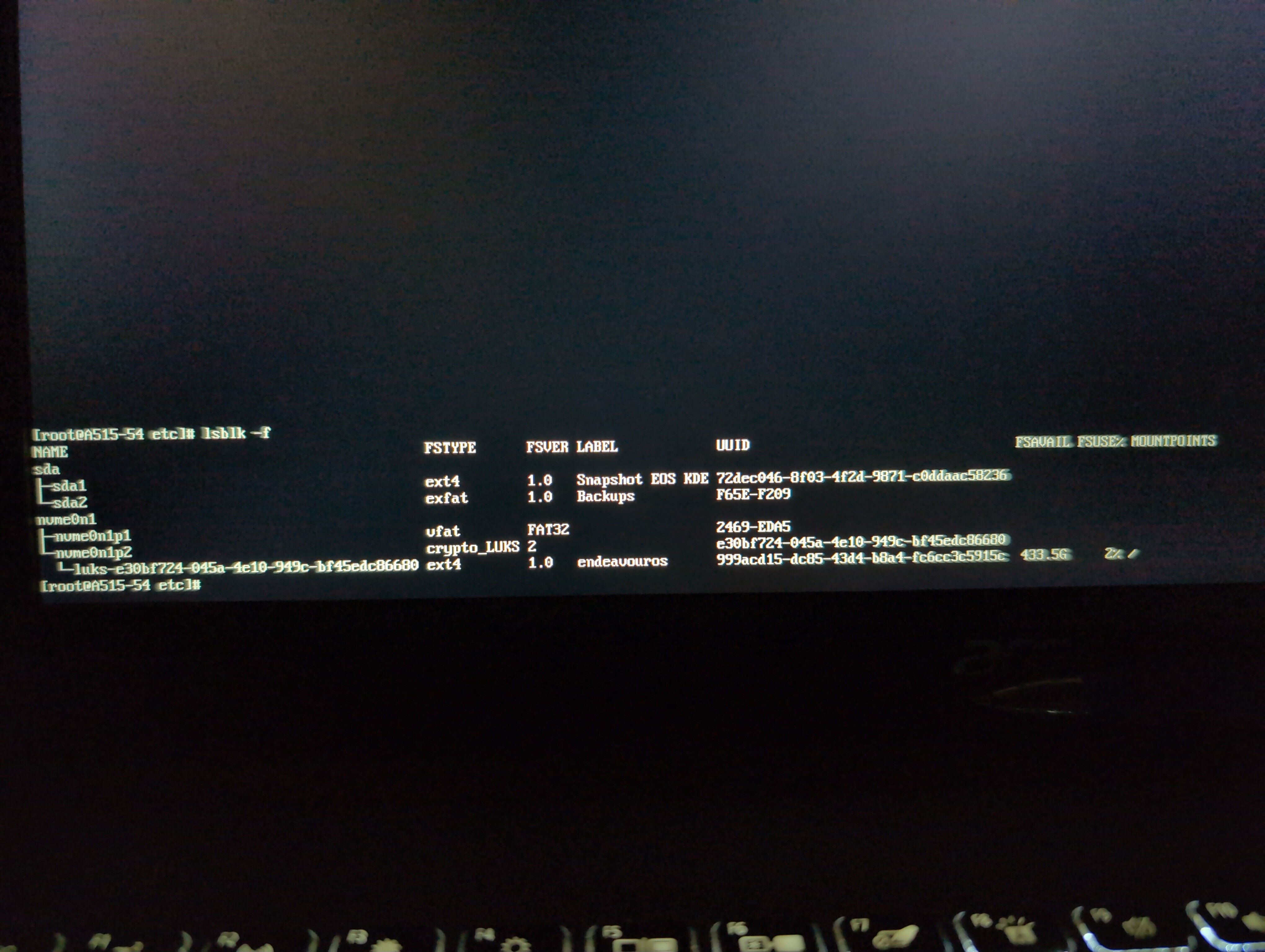

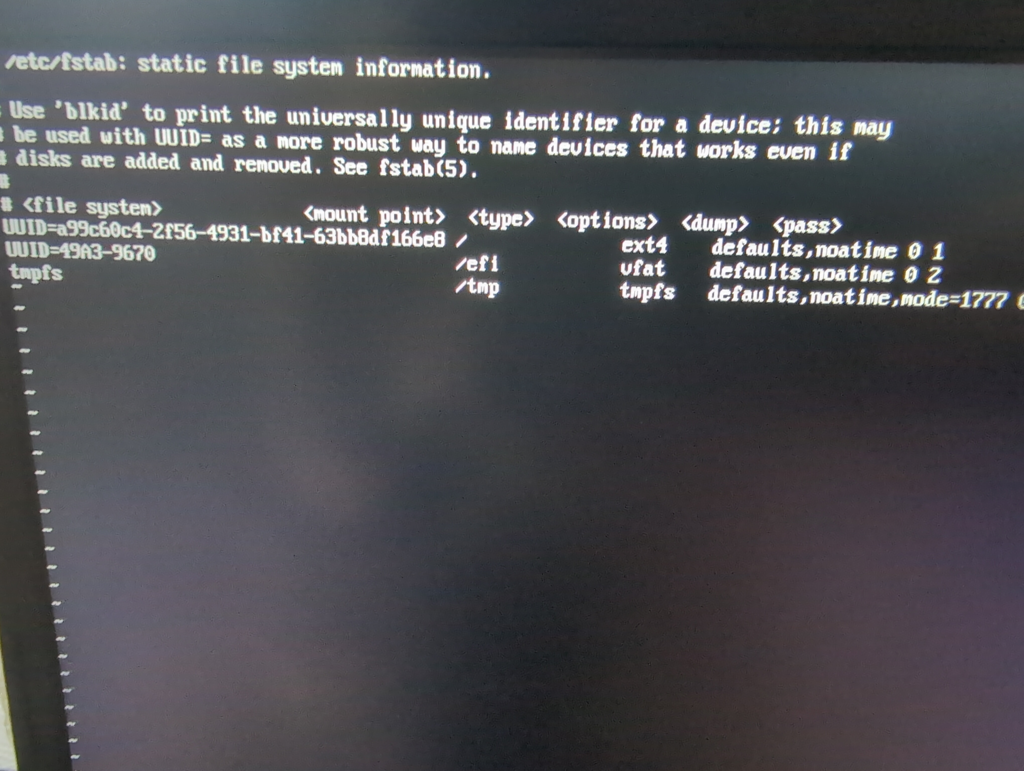

Below is my current UUID when viewing fstab, are we talking both root and EFI or just EFI that needs to be changed?

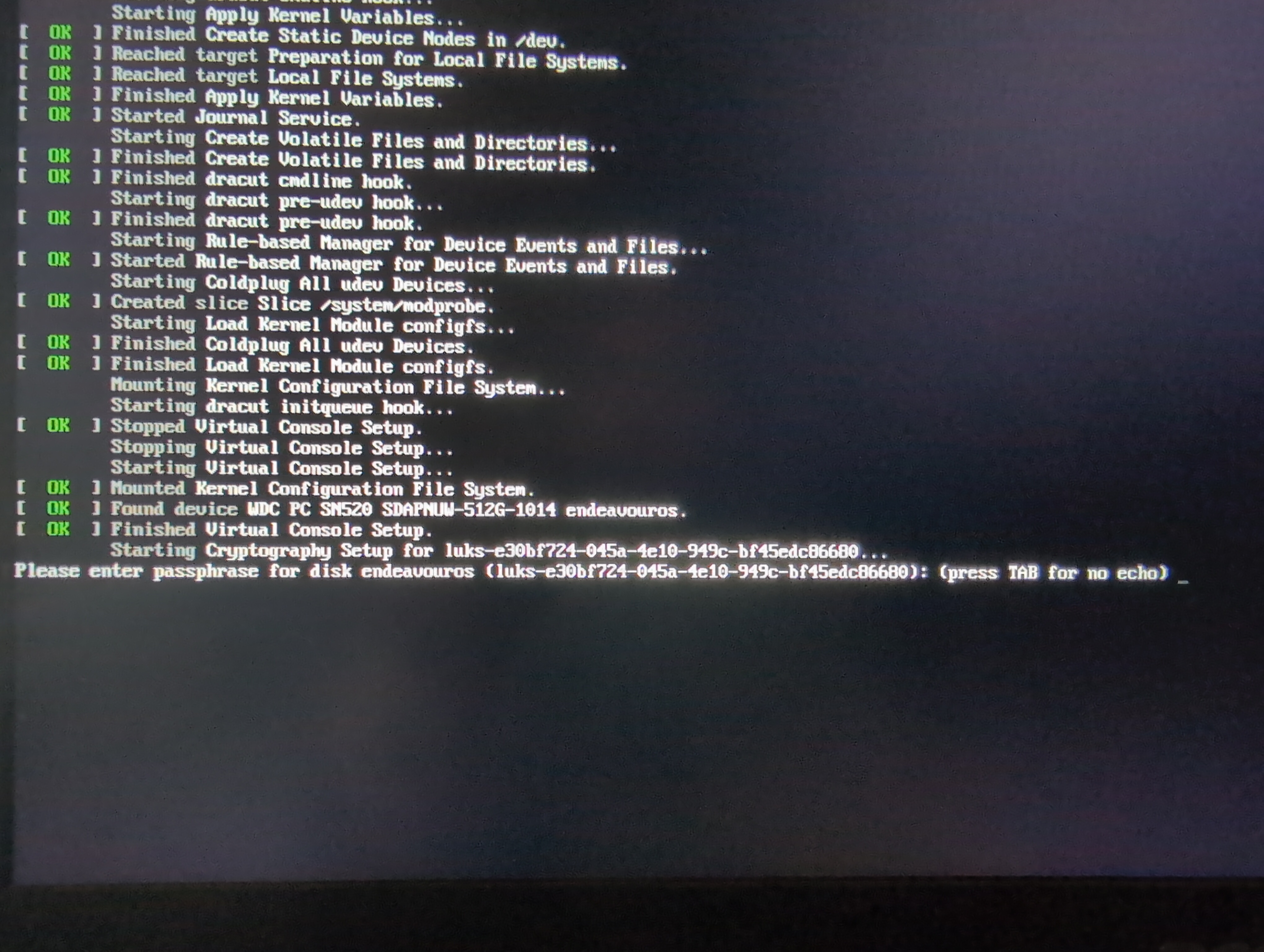

Below is the info when I’m still booting, is the luks code the new UUID I need to put into fstab? Don’t see any EFI UUID though.
lsblk -f

just the EFI

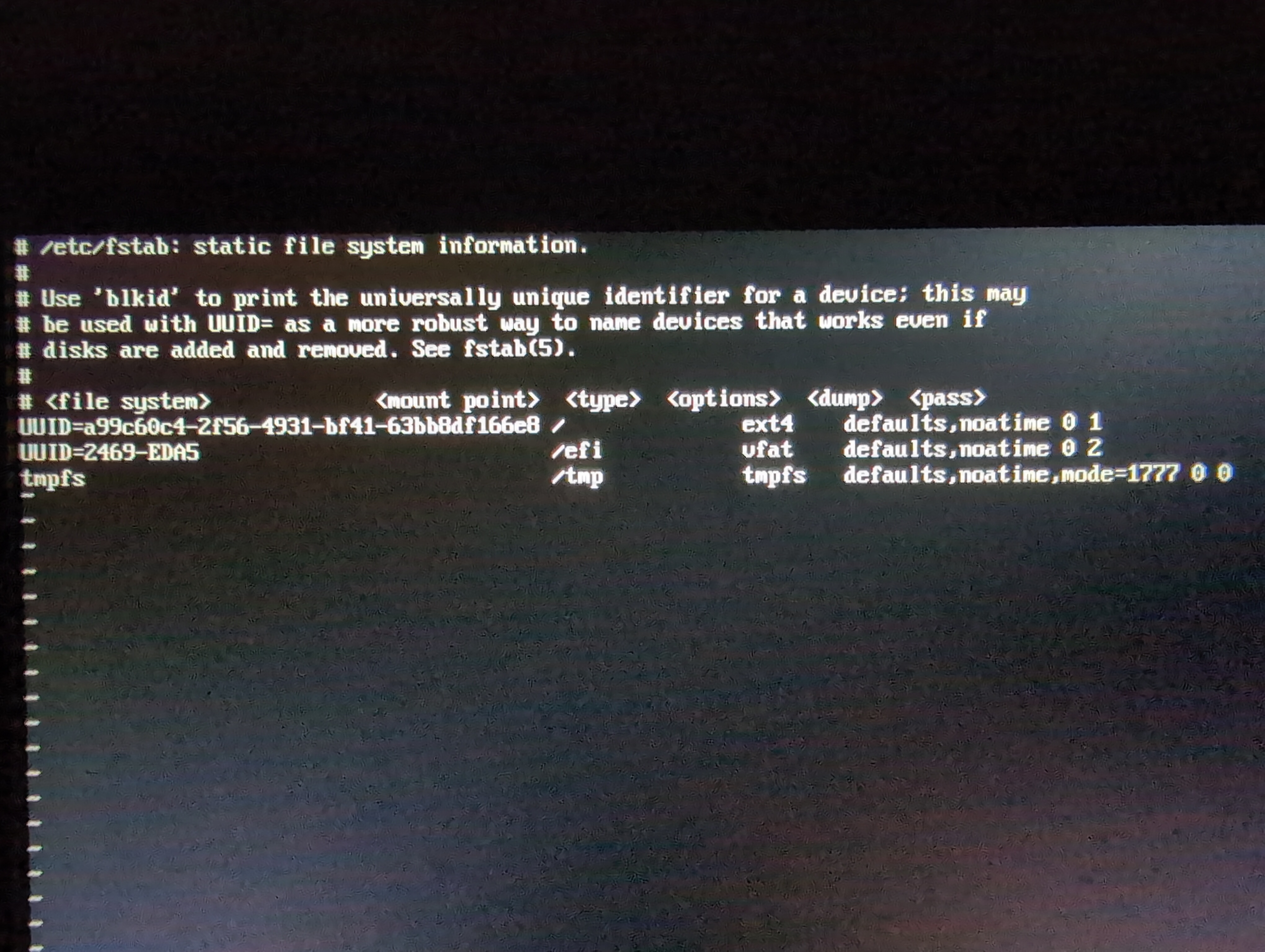

I pulled the UUID out of my n1p1 which was 2469-EDA5
Then I set the fstab EFI to the same UUID

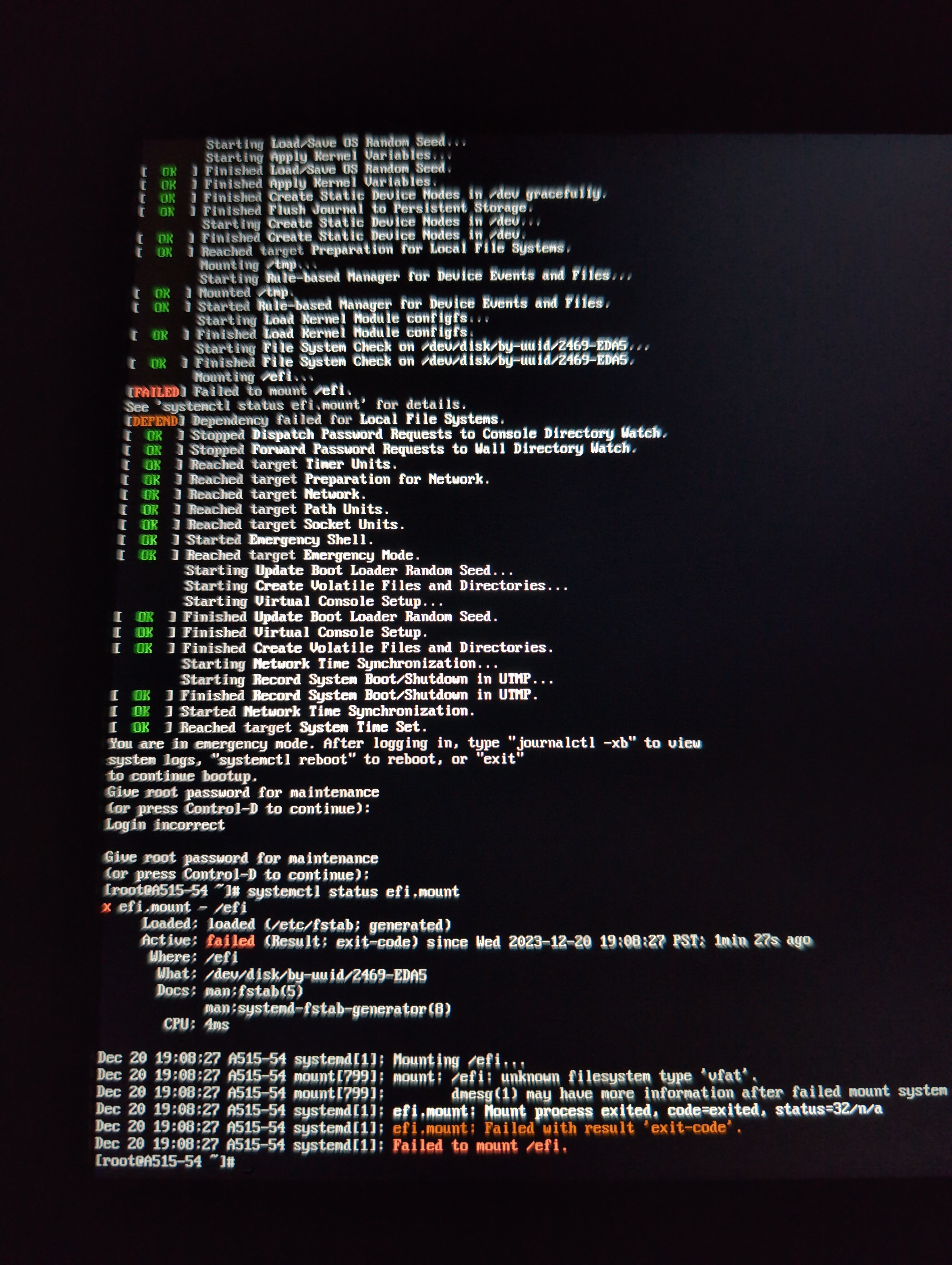

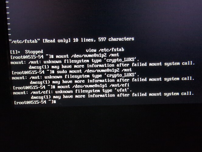

After rebooting i received this error, failed exit-code
I tried to mount just to see what happens

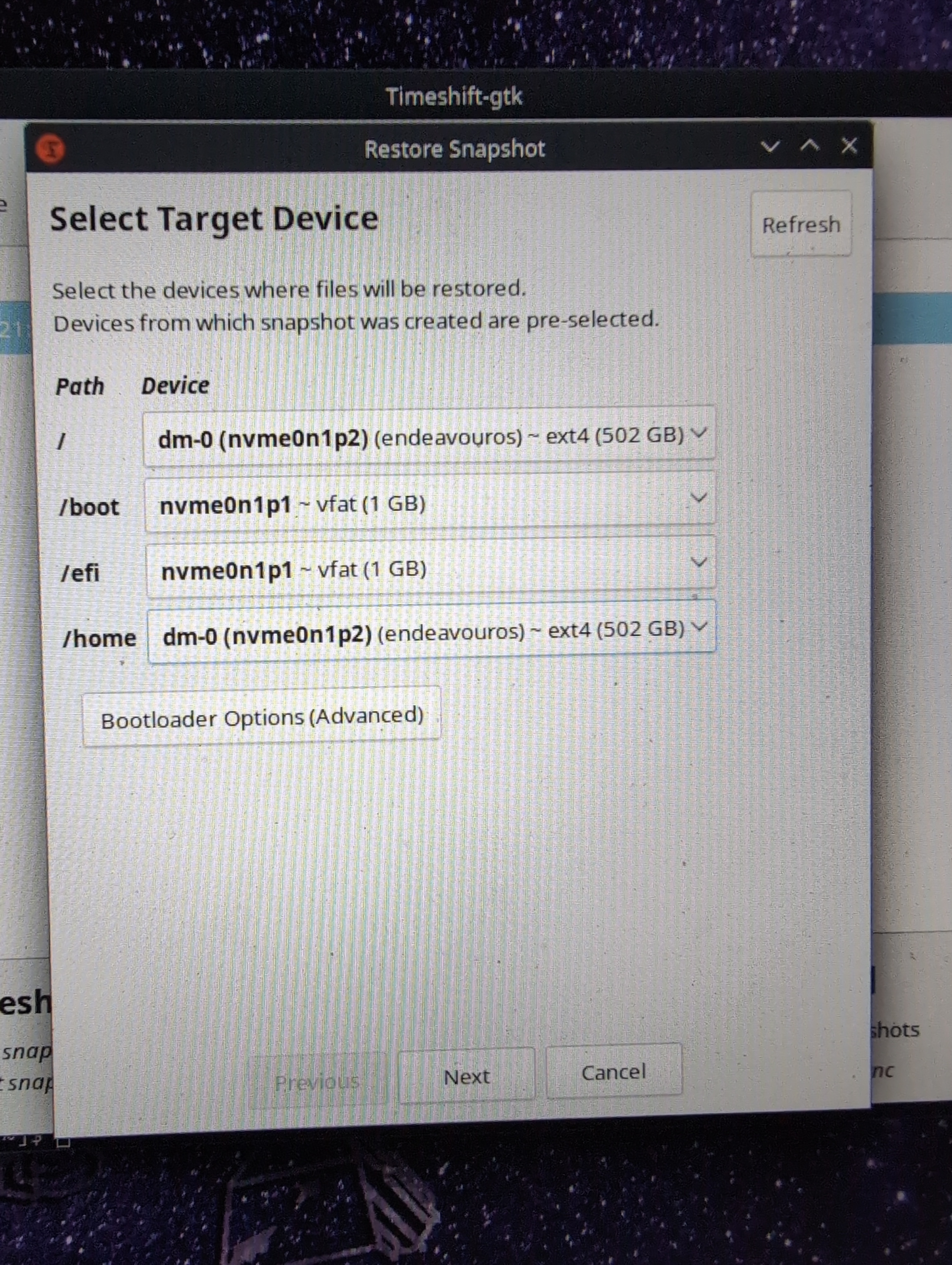

So my original system when I made the timeshift backup was not encrypted, just ext4 with fat32 EFI, this new partition is encrypted ext4 luks with vfat. That may be why it’s not able to mount? I’d rather keep it encrypted but if it’s not possible to keep the recovery then I’ll repartition without the encryption if that’s the compromise needed.

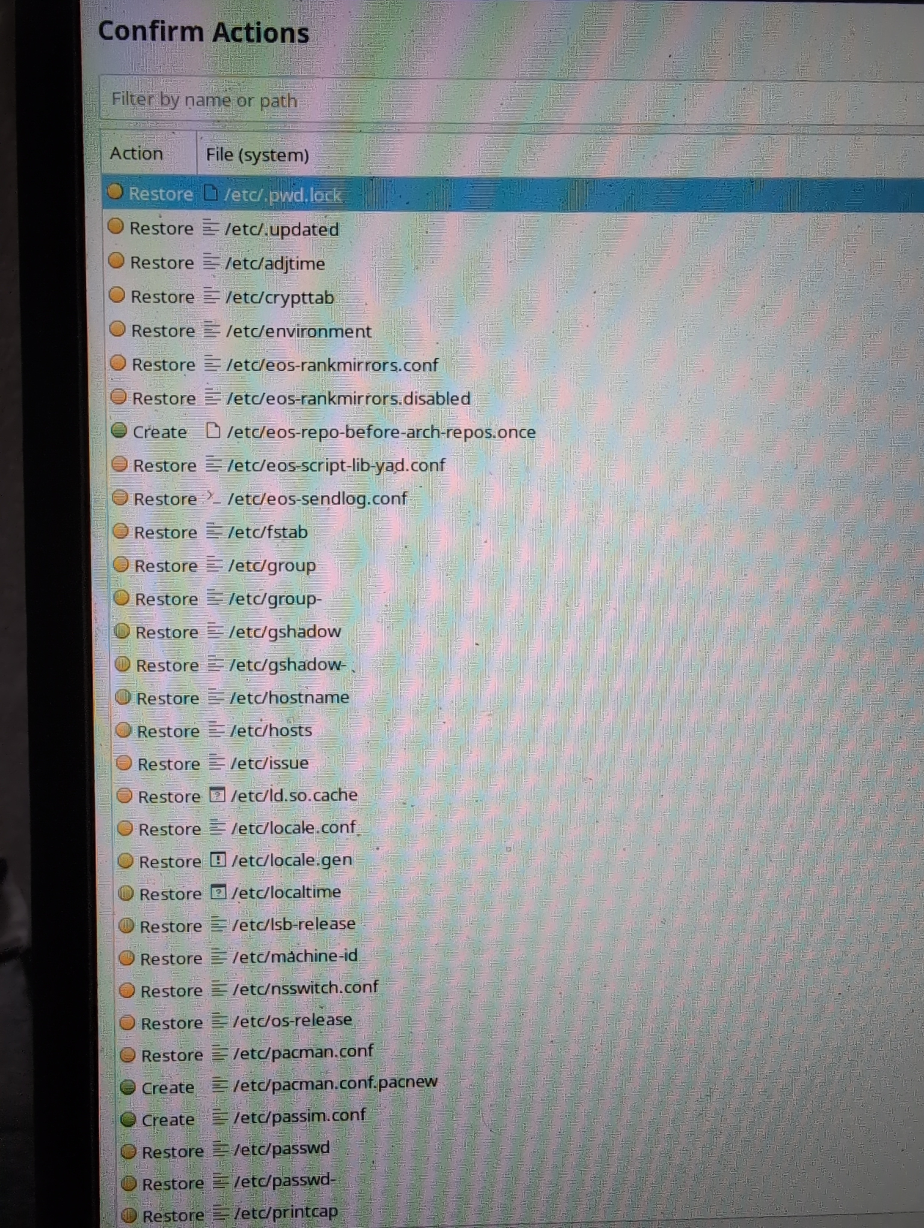

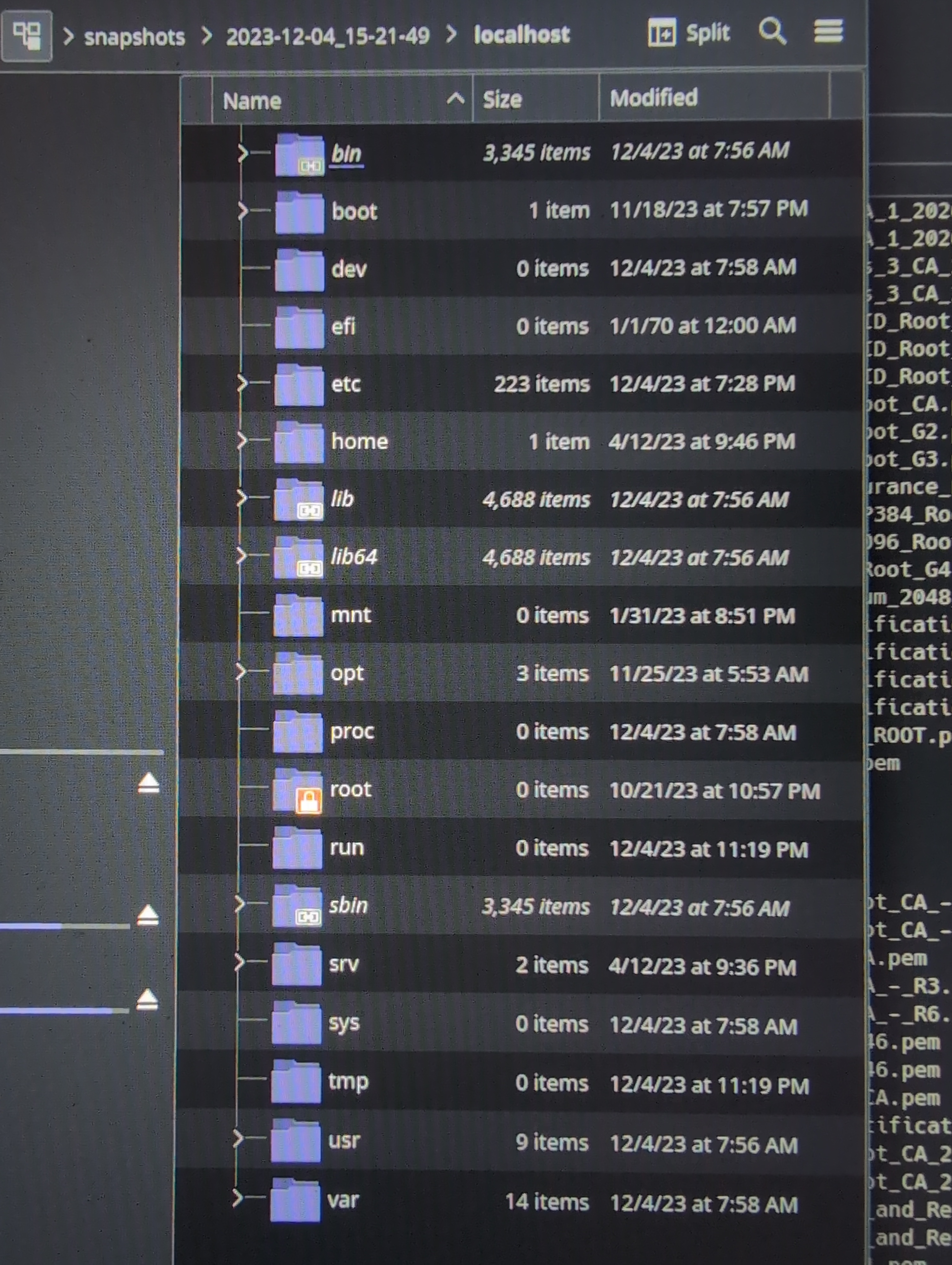

There are 12gb in that time shift restore file, probably 10k files or more and for me to figure out exactly where all my customizations are is a bit daunting. You’re right though that all that clutter is extra baggage.
You said the apps are in the / and the system tweaks are in/etc. Would this mean I should only have those two folders selected after another clean install? I’d still run into this issue where it doesn’t recognize the system format. Would I need to install ext4 unencrypted in order to recover these settings?

I get where you’re coming from, the etc folder is only 7mb so I don’t see why not just copy the whole thing? I have no idea where the layouts would be, the macros or startups etc.
I remember most of my apps being in the /home/.local folder which is obviously gone.
Just for knowledge are there any other folders in this backup list that are worth looking through for apps or otherwise? Didn’t see much poking around.
I guess you could do that if you wish. I wouldn’t do that personally. As mentioned already, if there is something specific I need, /etc/default/grub as an example, I would just grab it from the backup.
Also the binaries for the apps you install should be under /usr/bin but you will find mostly binaries from the base system installation. Also some apps could get installed under /opt.
