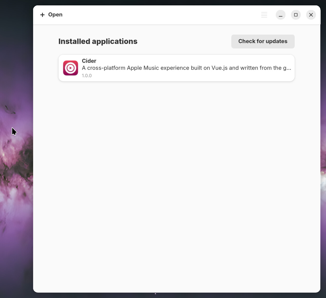

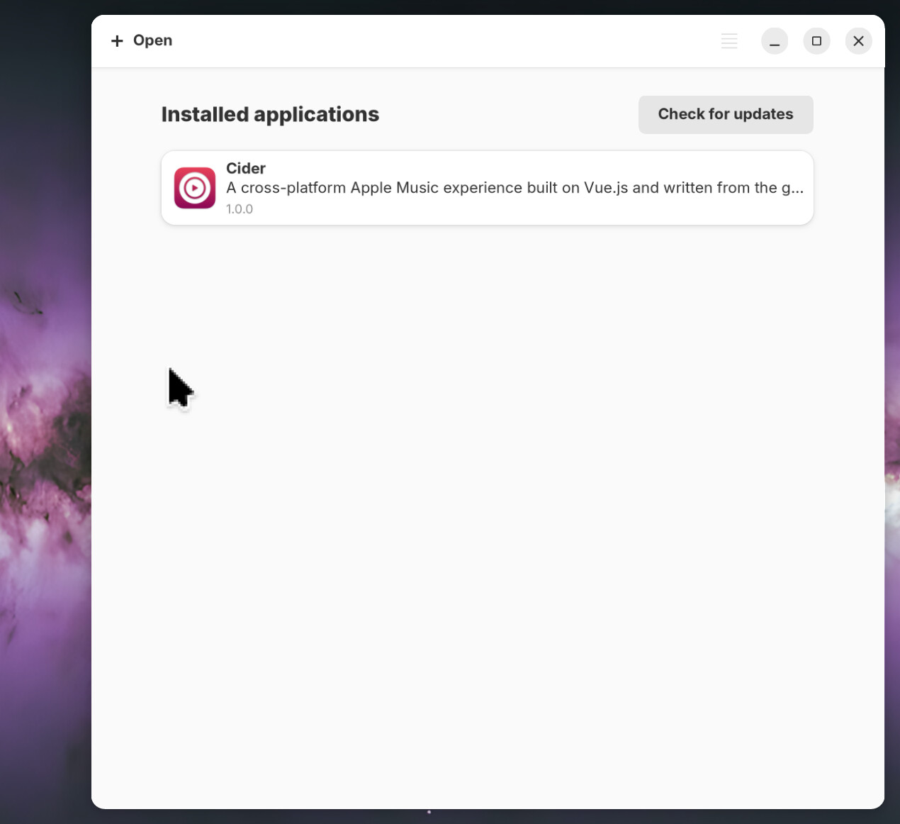

If you’re talking about the cursor only appearing large on specific apps, it seems some GTK apps don’t recognize the smaller, default size. I have that issue with Gear Lever…
