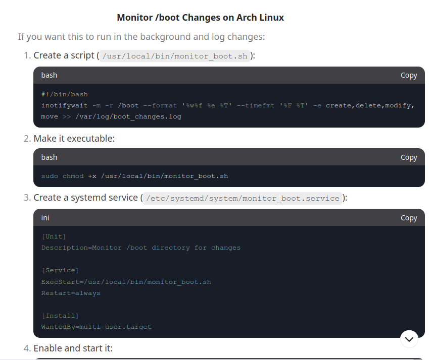

For info, I got a very fine reply from deepseek (I am in China now) :grinning_face:
https://chat.deepseek.com/a/chat/s/b3f19bed-3b7a-4aae-ba03-a2d9480d37b2

            Persistent Monitoring (via Systemd Service)
    If you want this to run in the background and log changes:
        Create a script (/usr/local/bin/monitor_boot.sh):
        bash
        Copy
        #!/bin/bash
        inotifywait -m -r /boot --format '%w%f %e %T' --timefmt '%F %T' -e create,delete,modify,move >> /var/log/boot_changes.log
        Make it executable:
        bash
        Copy
        sudo chmod +x /usr/local/bin/monitor_boot.sh
        Create a systemd service (/etc/systemd/system/monitor_boot.service):
        ini
        Copy
        [Unit]
        Description=Monitor /boot directory for changes
        [Service]
        ExecStart=/usr/local/bin/monitor_boot.sh
        Restart=always
        [Install]
        WantedBy=multi-user.target
        Enable and start it:
        bash
        Copy
        sudo systemctl enable --now monitor_boot.service

this is how the deepseek output really looks (part of it)
