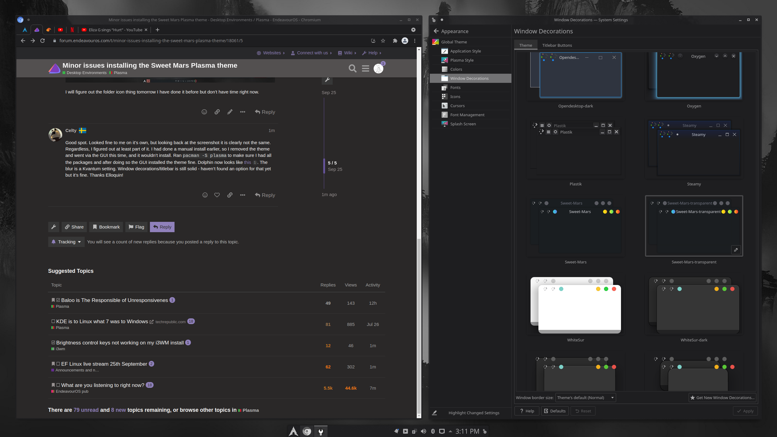

Good spot. Looked fine to me on it’s own, but looking back at the screenshot it is clearly not the same. Regardless, I figured out at least part of it. I had done a manual install earlier, so I removed the theme and went via the GUI this time, and it wouldn’t install. Ran pacman -S plasma to make sure I had all the packages and after doing so the GUI installed the theme fine. Dolphin now looks like this. The blur is a Kvantum setting. Window decorations/titlebar is still solid - haven’t found an option for that yet but it’s fine. Thanks Elloquin!
You should have this one if not download and apply it:
Screenshot_20210925_151138
Yeah that’d be it, had it on earlier but it reset when I removed the theme. Looking perfect now!
