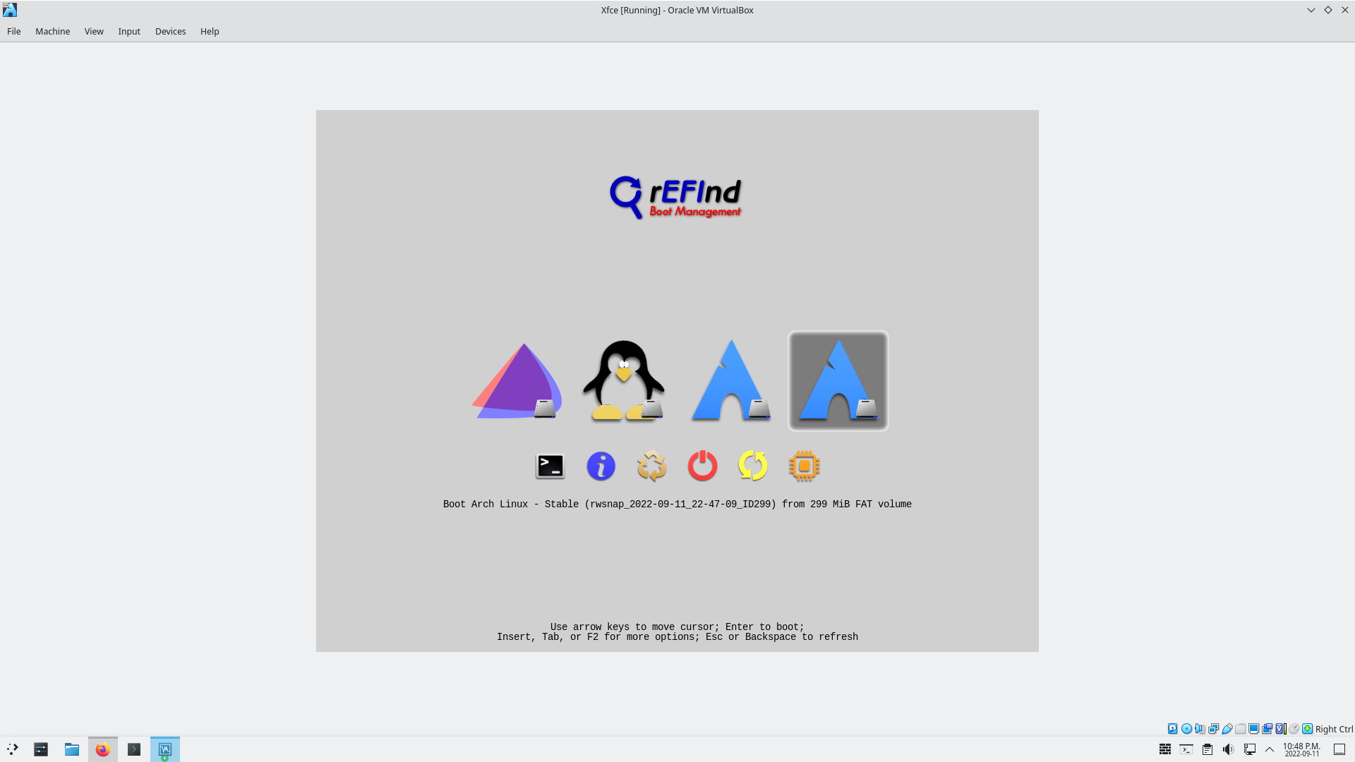

I have no issue setting it up with booting from grub or the vmlinux-linux image file. On grub i can boot and have the snapshots because it’s grub. Booting from the image file and trying to set it up with refind-btrfs isn’t booting for me. It ends up messing up the current image file to be able to boot from it. I have been able to get a snapshot icon on the screen but fails to boot also.
Ok, tha didn’t work either. This is pretty frustrating. It’s not the end of the world, the snapshots are visible in grub if I really need them. But it’s the principle of the thing, I want to get them visible in rEFInd too. ![]()
Messing with it in vm but i still can’t get it to boot on the arch icons or snapshot entry. I also don’t know how to create more snapshot entries? snap-pac makes lots. Just don’t have enough understanding. But i tried. ![]()
Edit: The snapshot entries are there if I press f2 but none are bootable.
What happens when you select that entry (shown in the second picture)?

When you click on it and press enter it just stays at the same spot. I’m not sure if permission changes are needed to be made to the snapshots? It just kind of flickers but does nothing.
Edit: I’m not sure whether i have it configured correctly either?

I can understand that. I just have xfce on btrfs with swap file. I installed btrfs-assistant, snapper and snap-pac.
I set up btrfs assistant snapper config for root only. I then installed refind which works to boot from grubx64.efi or the vmlinuz-linux image file. Added the icon for eos using the grubx64.efi. I kept theTux icon for the vmlinuz-linux imag file. Then i installed refind-btrfs.
I added to scan all dirs with also_scan_dirs @/boot,ESP2:EFI/linux/kernels
I added this manual stanza
menuentry "Arch Linux - Stable" {
icon /EFI/refind/icons/os_arch.png
volume ARCH
loader /@/boot/vmlinuz-linux
initrd /@/boot/initramfs-linux.img
options "root=PARTUUID=4291d82f-b88f-4b2d-89e0-738d44b6e8c3 rw add_efi_memmap rootflags=subvol=@ initrd=@\boot\amd-ucode.img"
submenuentry "Boot - fallback" {
initrd /@/boot/initramfs-linux-fallback.img
submenuentry "Boot - terminal" {
add_options "systemd.unit=multi-user.target"
I think that’s all i did but not sure if i forget something. I don’t think i did anything else. I did look at the refind-btrfs.conf file.
