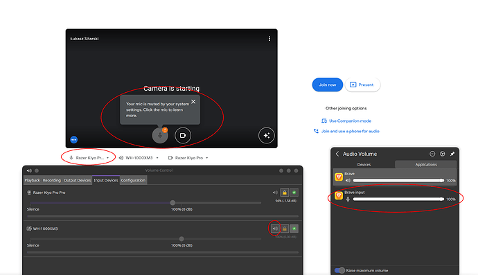

When joining the meeting on Firefox/Chrome my microphone does not work, but only when my headset is connected. I was able to debug it a bit and it seems that the reason is because there is additional Input Device which should not exist:
I don’t know how, but when I was tinkering around with the settings, I was able to remove it from the Input Devices and the microphone was working well.
Then I turned off and on headset which restarted the settings, and now browsers do not detect my microphone again (until I disconnect headset).
It’s worth to mention that pavucontrol shows constant input on proper microphone, however the browsers are muted.
