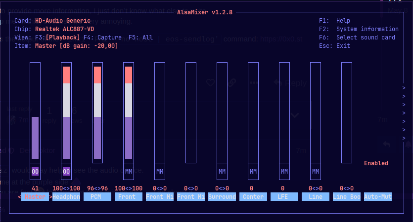

You should check alsamixer from terminal and press F6 to choos ethe intel card and F4 to select to show input channels…
Could be there are microphone channels for mic boost per example or line in and boos… you can try disable line in and or the boost channels.

And for the alsamixer stuff: After I pressed F4 there are 3 channels there: Mic Boost, Capture and Internal Mic Boost. The Internal Mic boost was set to 100%, I set it to 0, and everything was fine, but then I plugged in my controller, and it was back at 100%.
